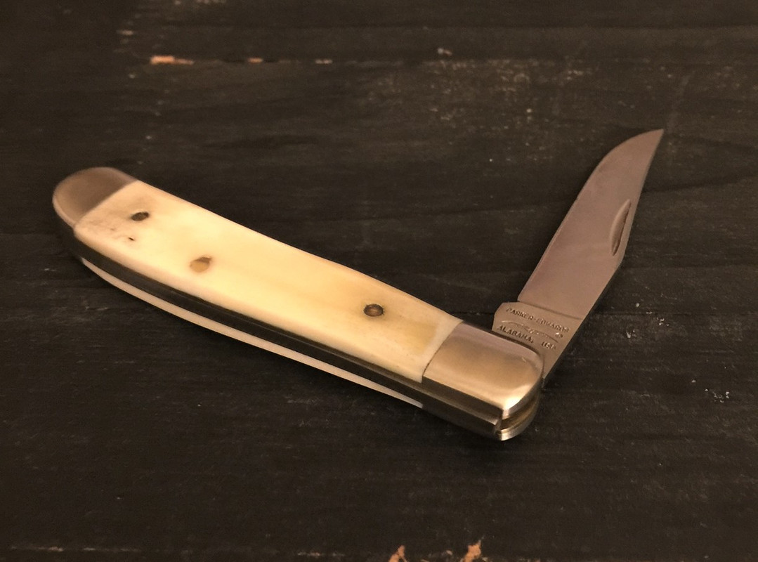

Boker Tree Brand with Smooth Yellow Bone Covers
I've been eyeballing the Boker Trappers but was wondering if someone can answer about the "High Carbon Stainless" blades. I guess I always assumed high carbon content made for a blade that took on a patina and stainless was well....stainless. Do the Bokers take a patina like a Case CV or GEC 1095?
High carbon stainless just means it has about .5% Carbon or higher, so the blade will take a proper hardness. Stainless generally means it has at least 12% Chromium to resist rusting. For many years Solingen stainless steel was roughly 440B in composition, or about .75% carbon, same as their C75 carbon steel blades. The stainless just had the added Chromium as well. I'm not certain they still use the same steel now.
