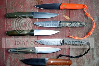

What are everyone's thoughts on the popular tend in buschraft knives with such thick spines? I ask beacause we were sitting around the firestation today and the guys asked me why my bush knives were 5/32. I replied with that was all I needed and I did not want the extra weight from an over built knife. Do y'all think the current trend in popular bush knives are too thick for their use?

I agree with you guys as testing the knives I make 5/32 O1 has been plenty. I see Aldo only has 1084 in 1/8 and 3/16ths. Do yall think I can get away with 1/8th on the style of blades I build and still get rough use from them using 1084 1/8th?
I have yet to damage any of my 1/8" 1084 knives in normal use. I've broken off really fine tips doing stupid stuff, but it generally gives plenty of warning, like bending and getting unbent a few times. lol
The only issue with thin steel is that it flexes more, particularly as you get less tall blades so there's less steel involved for a given length. Still, for a bushcraft role knife that's not an issue, it's not like it's a filet knife type flex. You just wouldn't want to be trying to lever rocks out of the way or something, you'll wind up with a bent knife.

I've batoned with 1/8" spines without a problem. I think it's silly to go past 1/4" thick, it just makes it much harder to slice anything effectively. Although I can see why the large knives might need such a spine, since one can apply more leverage to snap the blade. But in the smaller knives, going that thick is overbuilding, especially in folders.
1/8" will be plenty. I have not made a bushcraft knife in the 4" blade range that is thicker than 1/8". And I along with a bunch of other people have beaten the crap out of my knives without any issue. My blades were either O1 or CPM154.

I agree that a final spine thickness of 1/8 - 5/32" is plenty for bushcraft/general utility knives. 1084 and O1 are both quite tough and will perform very well at those thicknesses, with a tall grind. I like your design; try grinding one even thinner and see if you like it. At the very worst, it will end up being a light "bird & trout" type knife with a bit of flex and a very keen bevel. :thumbup:
