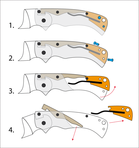

I like the idea.Russian )
This is familiar to everyone. Dirt, sand, fat from products sometimes get inside the handle and it requires cleaning. With the possibility of incomplete disassembly of the knife, it will be easy. The quick-release backspacer can be mounted on the principle of weapon pins or other similar maintenance systems without tools. And this will not affect the strength of the blade fixation.
Plus, easy repair and adjustment/replacement of the lock spring for personal preferences "tight" or "soft".
