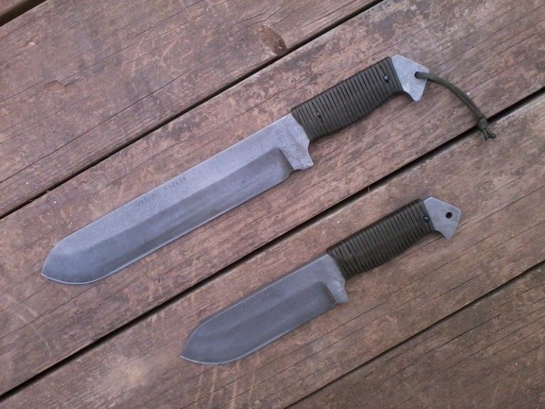

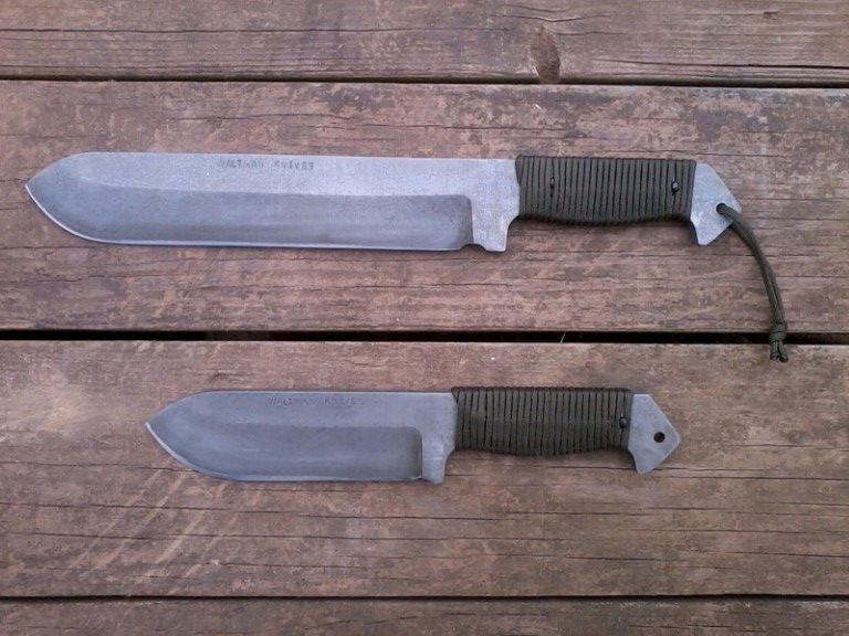

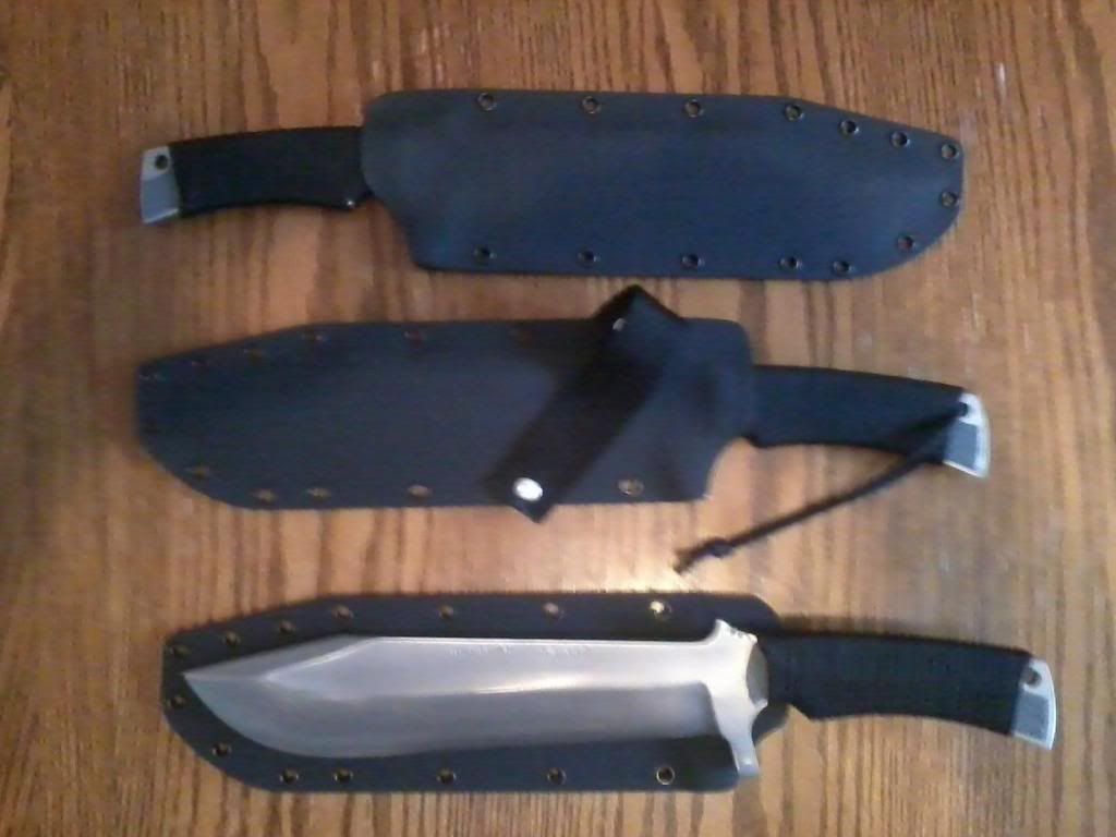

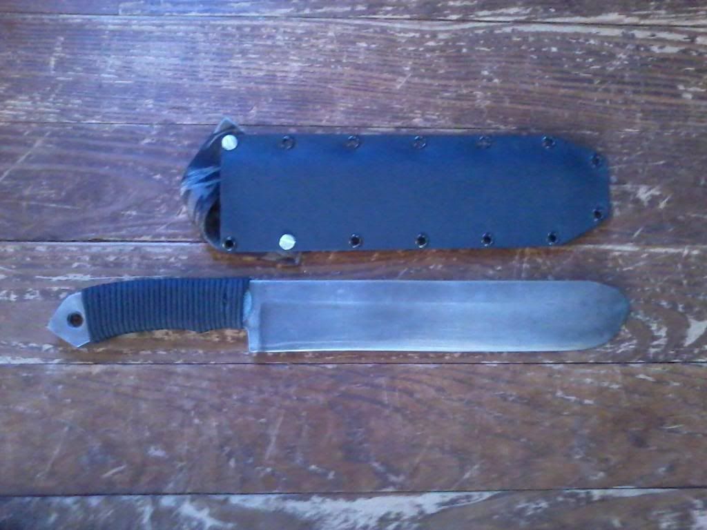

My first post, so I thought I would show you a couple of the knives I just finished.
My disclaimer is that in no way shape or form am I trying to capitalize on the Becker BK2 or profit from Ethan's' quality design. These blades were made in admiration of the BK2 only, and they are simply my rendition of this great knife.
I have been manufacturing heavy duty knives for a while now, and I wanted to make a super sized version of the BK2. They are 3/8" thick and made from 5160 truck leaf springs that have been deferentially heat treated. The first has a 6" long blade and the second has a 10" long blade, respectively named the HD 6 and HD 10. You guessed it, HD means Heavy Duty. I have found these knives to be indestructible. The drawback is that they are on the heavy side, but they are made to be more than just knives. Pry, dig, throw, stab, and anything else I could throw at them, they just smile and ask for more. OK, so maybe I am just a little proud of them. :-)
What I like best about these knives is the handle design. When chopping with the knives, the hook for the hand really keeps the knife in place.
Becker knives are great knives, these are just Becker like knives on steroids. Hope you like them.
I LOVE them! I would buy one in aq reakin heartbeat. Let me know if you plan on selling someyhing like this:)
Good looking knives. Whereabouts in VA are ya?
Looks pretty good from here. We're gonna need some action pix though. Semper fi
That is awesome. While I definitely see where the inspiration came from, I wouldn't consider these a Becker rip-off.
I think we should test it! I have a three day weekend coming up if you need help with that! ;)
Seriously cool though.

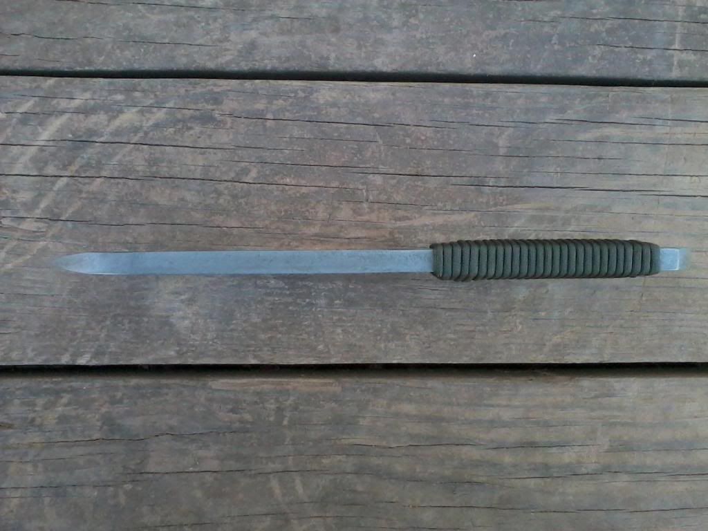

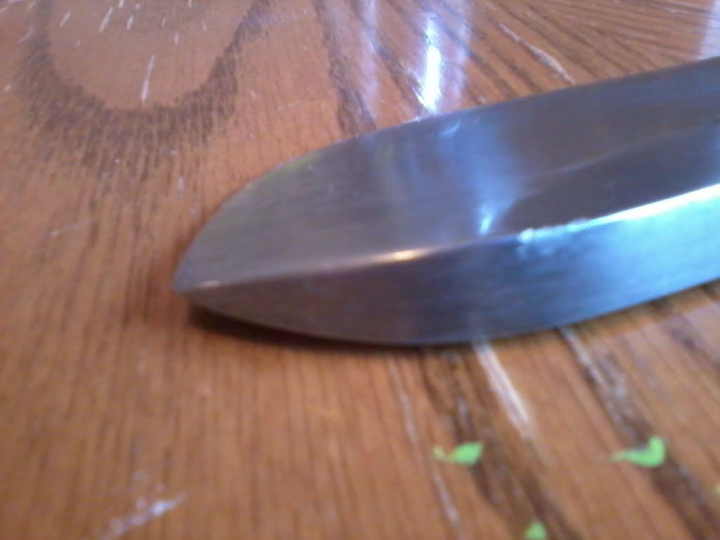

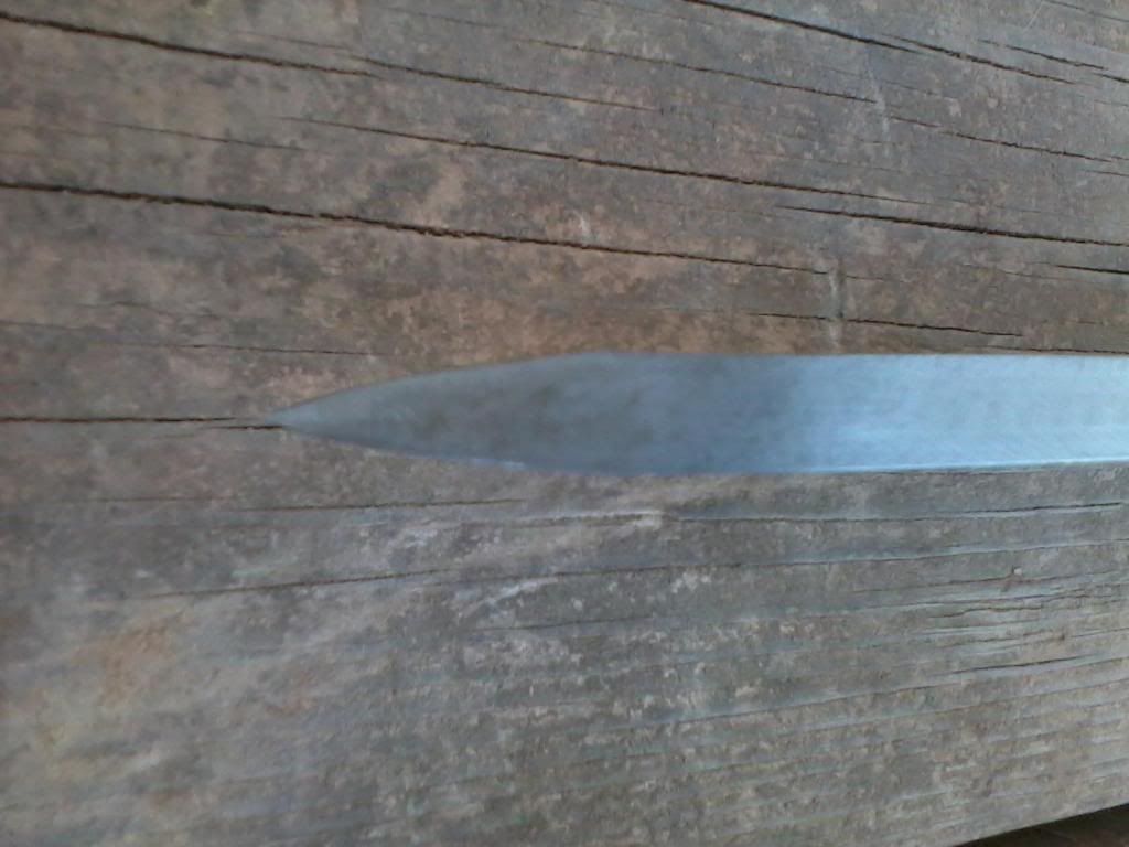

I snapped a couple more quick pics of the spine and point strength of these knives for your viewing pleasure. I will try to answer all your questions in just a moment.
The pics really don't do them justice. Sorry for the bad cell phone pics.

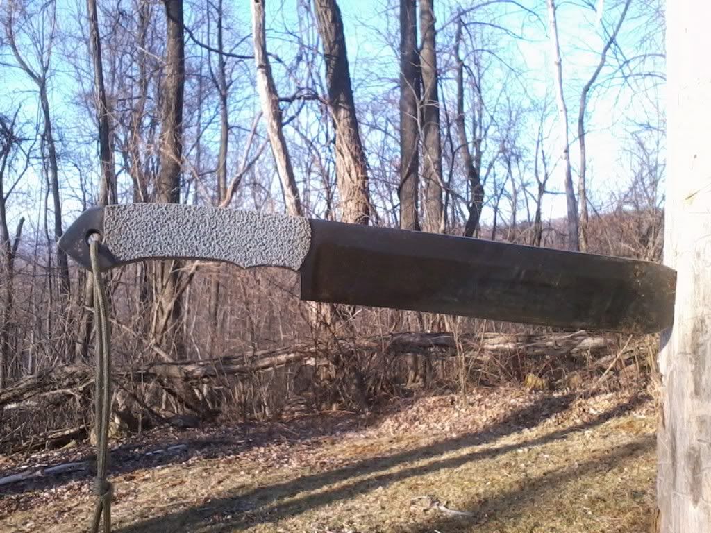

I call this one the Grunt. 11" blade and 7/16" thick.

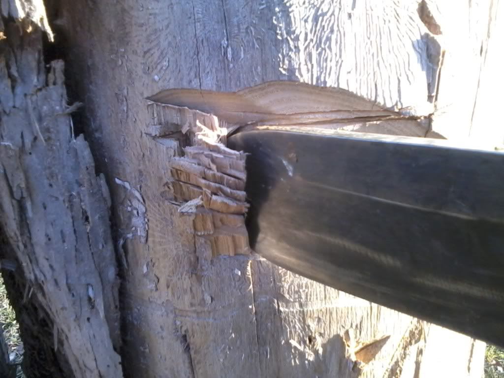

Extreme point strength.

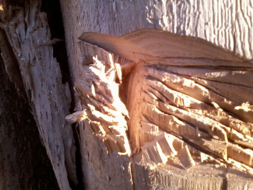

One swing to gut a softball.

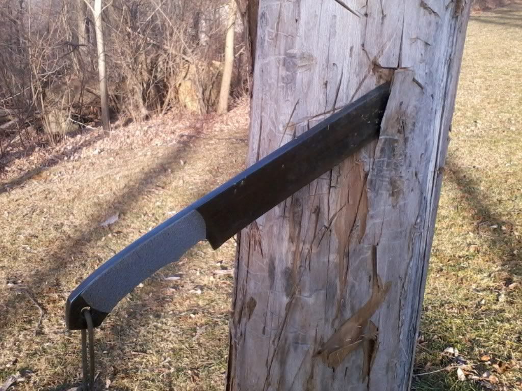

Thrown over 100 times at the tree. Only got it to sink in about 10 times, but boy did it ever sink in.
When it stuck, the goal was to snap the handle sideways to try to break the tip. The only thing that gave was the tree.
