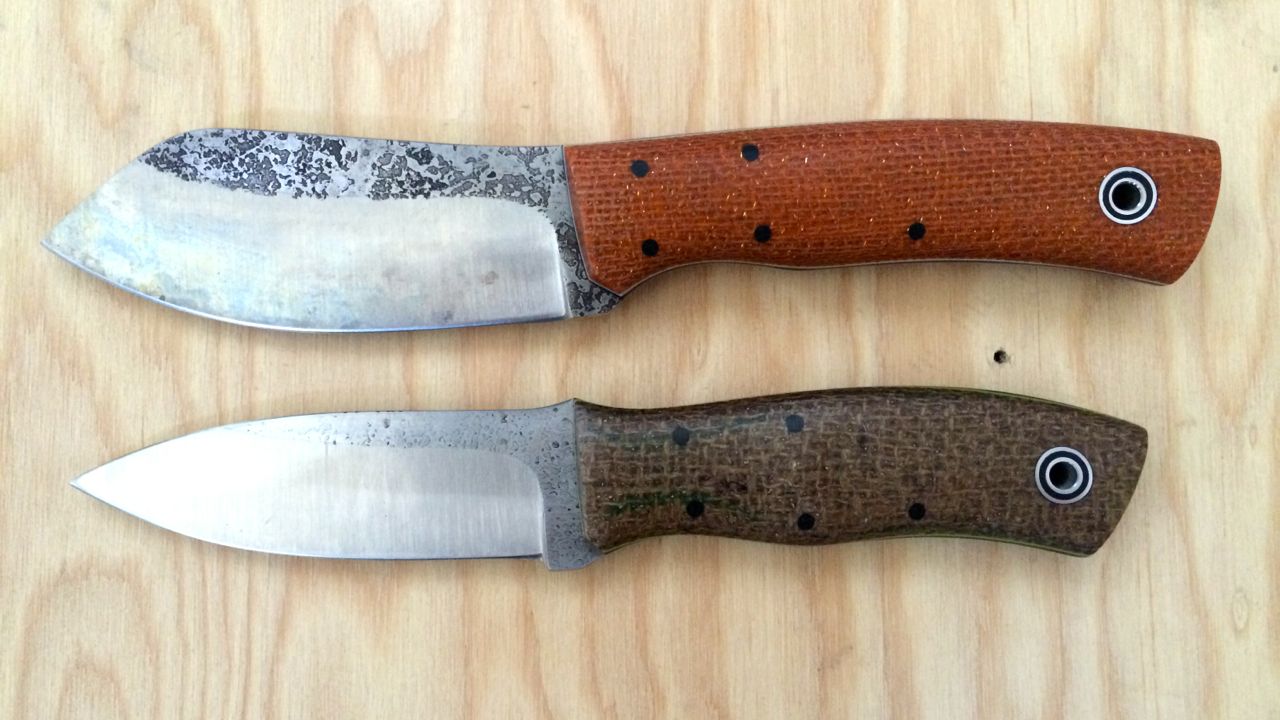

Nathan chose three models that I didn’t have based on his knowledge of my collection. In addition to the requested K.E Bushie, he sent his Runt and ED Karda as the surprise additions. I only have a couple of 3” models, so it was nice to get a couple of small ones to try. This set was a great selection on his part.
Here are a couple of photos of the knives that I received from him:
The K.E Bushie is 1/8” thick O1 tool steel with a full tang and a Scandi grind. The spalting on this knife reminds me of a stone-washed granite finish - very nice! The handle is Shadetree Electric Orange burlap over black micarta with an orange pinstripe and black micarta pins. It is 8-3/8” overall length and the blade length is a little over 3-3/4”. It weighs 5.6 ounces.
The ED Karda is 1/8” thick O1 tool steel with a tapered tang and a convex grind. The spalting is an even light granite color. The handle is African Blackwood over natural micarta with a white pinstripe and natural micarta pins. This is essentially the wood version of a Tuxedo handle configuration. It is 6-3/4” overall length and the blade length is 2-5/8”. It weighs 3.2 ounces.
The Runt is 1/8” thick O1 tool steel with a tapered tang and a convex grind. The grind is full height, so it shows minimal spalting. The handle is Black Micarta over natural micarta with a white pinstripe and natural micarta pins. This is the Tuxedo handle configuration. It is 5-1/4” overall length and the blade length is 2-1/4”. It weighs 2.6 ounces.

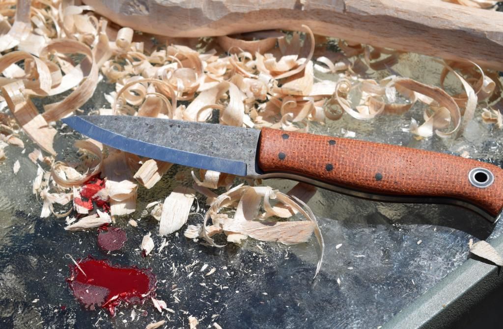

OUCH!! My second bite from a Fiddleback.
This is the first cut that I have ever received from a Fiddleback knife. I was rotating my grip on the spoon a little too quickly at the later stages of carving and this is what happened. It was a good bleeder. I did not plan to do any “game meat” testing as part of my review. Based on this impromptu test, I am convinced that the Scandi grind on this knife would work just fine processing game in the field.
In case you are curious, my first bite from a Fiddleback happened six years ago courtesy of a Brown Recluse (a.k.a. Fiddleback) spider that got me on my left forearm. The spider apparently caught a ride from back east in some boxes of hardwood flooring material. That bite was not something I would wish on anyone. I’ll spare you the gruesome photos of that wound.
After a band-aid break, it was back to work to finish things up as far as I wanted to go.

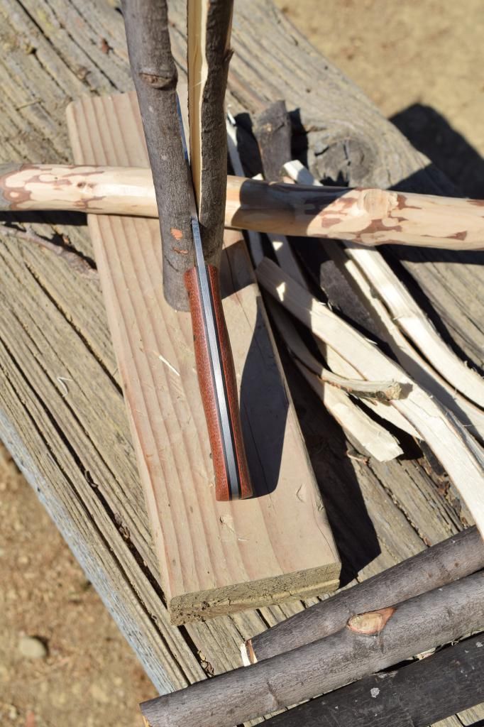

The Mini-Try-Stick Project:
After the K.E. Bushie and I made up, I decided to try it again on a mini try-stick type project. The wood used was Silver Maple. The Scandi grind really cuts through wood like crazy. Thin accurate shavings are no problem. The handle felt comfortable in various grips. I really like the continuous curve of the cutting edge for the way it works on long sweeping cuts where you start cutting near the ricasso and continue to the tip as you rotate your wrist. This geometry works for a smooth cutting stroke.
I wasn’t completely happy with how my through slot turned out, but that was my lack of skill showing through rather than any issue with the knife.

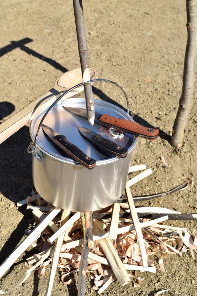

The Pot Hanger Project:
I recently picked up a new pot from REI for my camping box. I wanted something to use for stew or chili or popcorn over a stove or open fire. I decided to show how I make a simple pot hanger when I cook over an open fire. The pot hanger stays cool over a small fire. That allows you to take the pot off without burning yourself when the food is done.
First, I cut a wishbone shaped hook out of a forked branch. Then I cut a fish hook shaped notch toward the inside lower end of the longer arm. The notch can either be “J” shaped with a slightly rounded bottom or “V” shaped with a sharp corner at the bottom. The important part is that the notch should have enough of a lip or slanted ledge so that the bail of the pot will not slip off the pot hanger.
I used the ED Karda to make my pot hanger. It is a simple project.
I used more Silver Maple and the K.E. Bushie for the rest of the set-up. Limbing small branches was no problem. I used a folding saw to cut the two post pieces to the same length including the two-pronged forks at the top. I used the knife to sharpen the points of the branches that were set into the ground about 4”. The crossbeam piece was cut to length according to my anticipated fire size. I also split some kindling wood and shavings for the fire. Batoning the KEB through the approximately 1-1/2” thick branches was an easy task for this knife. I didn’t find the Scandi edge to work any better or worse for this task than other similar size convex knives.
Here is the result showing my typical camp set-up with the pot hanger in place. I didn’t actually start the fire because we are in a severe drought in California with open fires not allowed while camping in most of the state.

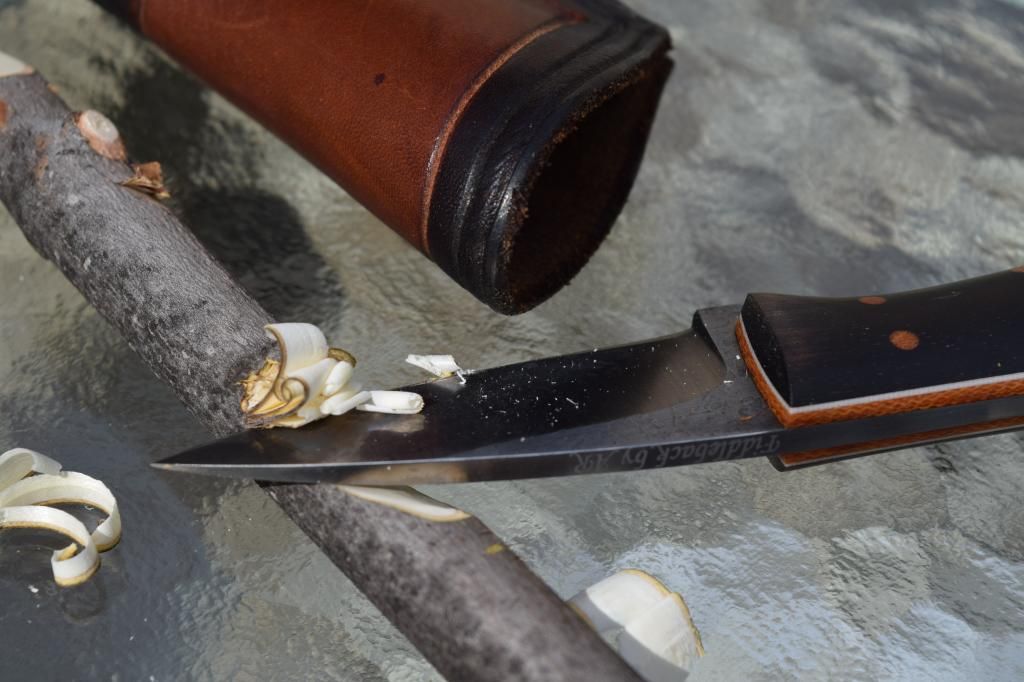

K.E. Bushie
This was the first Scandi grind Fiddleback that I have tried. I really liked the way it performed on wood. I like the continuous curve of the blade from ricasso to tip. It looks sexy and it works great for long sweeping cuts as you extend and rotate your wrist. Prior to this, I never seriously considered buying a Scandi Fiddleback before. One reason for that is because I have not developed the skill(s) to sharpen a Scandi grind to the same level that I can with a convex grind. The other reason is because I know enough about engineering to know that a true Scandi grind (no micro-bevel) cannot be as strong at the edge as a convex grind. Whether that translates into any real world difference, I don’t know. All I do know at this point is that I like this particular knife. The Scandi grind impressed me enough that I will be looking out for the right one on the Flea Market.
The round butt shape on the KEB is very comfortable to work with. The bottom edge of the handle has a more pronounced beak and slightly deeper curves on either side of the palm swell than my similar size Arete. The handle on this KEB is about .200” longer than my Arete. The center of the palm swell on the KEB handle also sits back a little further than it does on the Arete. I have a slight preference for the shorter Arete handle, but I would be very comfortable going the rest of my life with either one.
As a devoted Shadetree fan, I have to say that the Electric Orange burlap is some amazingly beautiful stuff. Lusting aside, I didn’t let that distract me from reviewing this knife objectively. I will have some Electric Orange burlap in my Shadetree “rainbow” eventually.

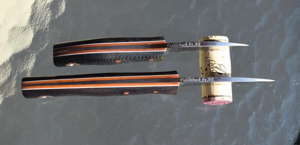

ED Karda
The ED Karda impressed me more than I expected. It is just a great whittling / general utility knife in a small package. The handle size is generous enough to provide good leverage and control without being too big. The short length of the blade makes precise tip control very easy. I will keep my eye out for this model if I can find one with the right handle material(s).

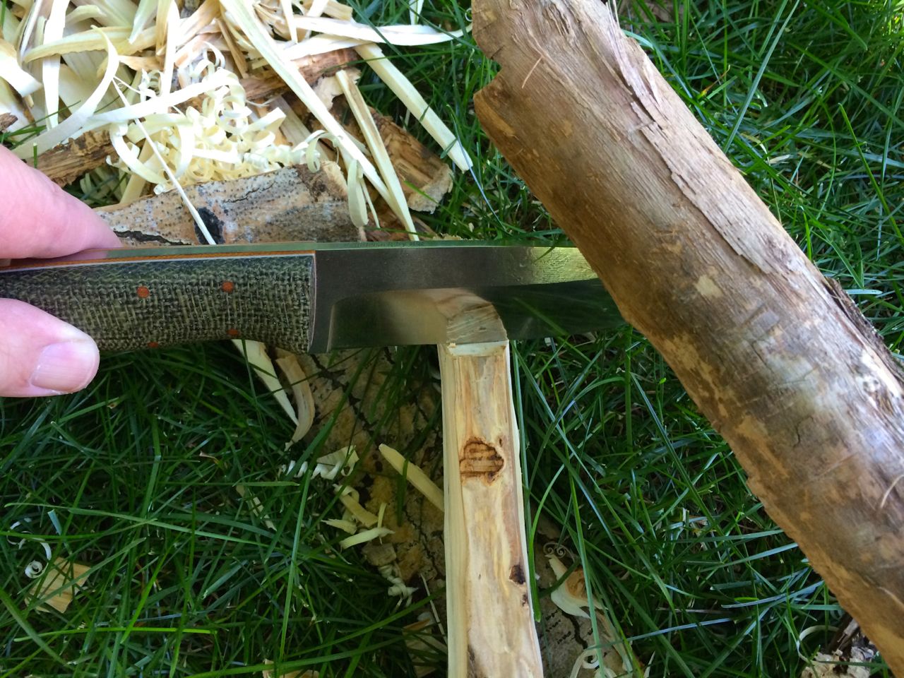

I also wanted to do some try stick work, so I grabbed a nice thick branch of maple, shaved it and started working on a hole through stick. This was some hard maple and really gave my thumbs and hand a workout.
IMG_4718_zpscd0a1f30.jpg~original
Here I’m trying to show what my standard push cut grip would look like. I tried taking the picture with the camera in my mouth but that didn’t work, so you’ll have to imagine my left thumb on the spine while the left hand holds the stick. You can see how the thumb ramp isn’t in the ideal spot. Adjustment was necessary.
IMG_4720_zpsfb6001c1.jpg~original
I also had some issues with a hammer grip, earning me a nice little bruise which is probably hard to see in this pic:
IMG_4784_zps5e399018.jpg~original
Regardless, hole through stick was a success. In 5/32″ with the high grind, this made quick work of thinning down the branch for the hole. I can also see how this handle is very comfortable in almost all cases. The tall handle, contour, everything, is just sweet. Make it an inch longer in the handle and I’m all over it.

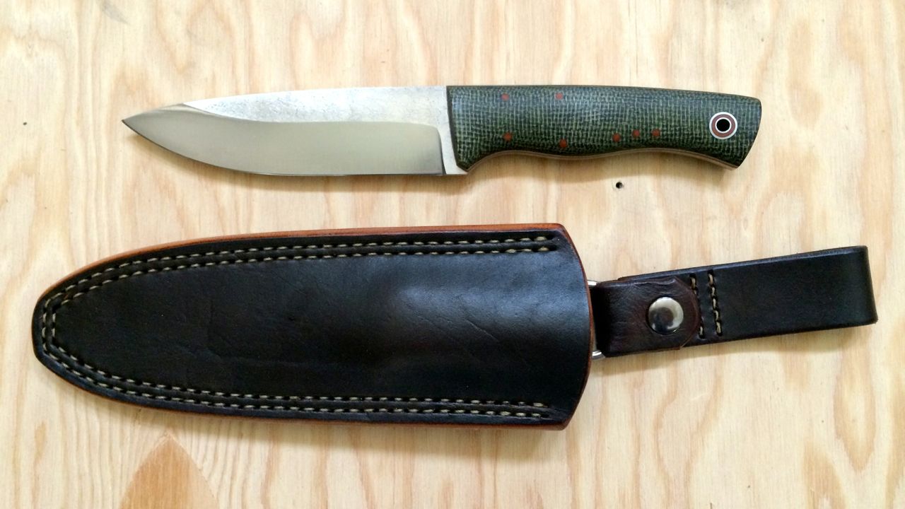

The Duke
The second knife that Phil sent me (one of the two bonus mystery knives) was the Duke. The name conjures up the image of John Wayne, sitting on his horse, Fiddleback hanging from his belt. Again, some stats:
OAL: 10-1/2"
Blade Length: 5-3/8"
Handle Length: 5-1/8"
Steel & Thickness: 3/16" O-1 Tool Steel
Tang Type: SFT (“skeletonized full tang”)
Grind: Convex
Handle Material: Forest Green Burlap from Shadetree over natural canvas with a lime green G10 pinstripe and Trinity pinout
Weight (oz.): 9.2
IMG_4960_zps5a8bad39.jpg~original
The Duke has been on my wish list for a long time. As I mentioned earlier, knowing how well the Woodsman works for me and how close the Duke is to it, especially in the handle, I was pretty sure that this knife would work out well.

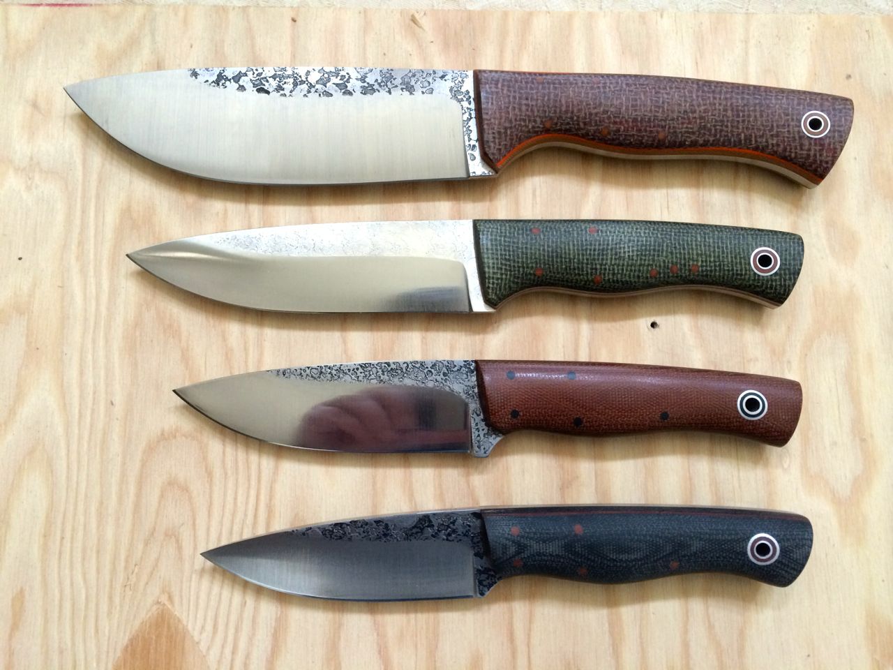

When looking at the models available from Fiddleback Forge, it’s easy to group them into some general sets based on handle shape and blade shape, with the size being the main differentiator within the set. An example would be progression from ED Karda, Kephart, Bear Paw, Woodsman to Toothpick. Each of these have a pointy spearpoint and a handle with a squarish butt. In my mind, the Duke fits into a series that starts with the quintessential Bushfinger and progresses through the Hunter and Duke to the Camp Knife. These knives have a similar handle style to the previously listed set, but instead of a pointy spearpoint they have a drop point blade with a good amount of belly. I know I’m oversimplifying these groupings as there are lots of differences between them, but it gives me a way of classifying them. Including the Camp Knife might be kind of a stretch, since it doesn’t have as much drop in the blade and the handle has more pronounced curves and a flared butt similar to a khukuri handle, but let’s just go with it for now. More on the Camp Knife later. Here we see this group together:
IMG_4958_zps65173526.jpg~original
And of course, I have to include a comparison with the Woodsman. It worked out pretty cool that Phil’s Duke and my Woodsman share almost the same handle config.
IMG_4488_zps9ccbebda.jpg~original
And here is how the Duke compares to the rest of my larger Fiddlebacks – Woodsman, Duke, Camp Nessie, Hunter, Bear Paw and Woodchuck:
