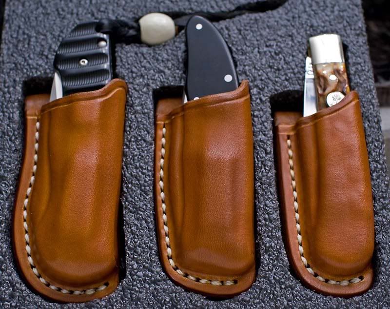

Had a fellow send in three folders to be leathered up,
here they are, resting in a piece of foam that I carved
out an area for each one to keep safe as they make
their way homeward bound.

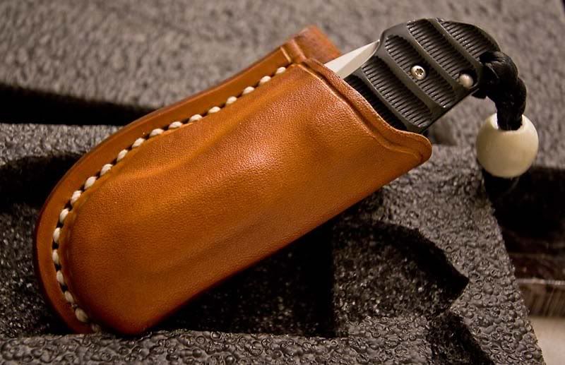

On the left is a Benchmade Apparition, then a Spyderco Viele and lastly a Boker trapper
a shot of the Benchmade, for this I wrapped a section of leather at the end of the clip
in order to keep the opening there when you go to return the knife, all three really snap
into place, but the Benchmade more so with it's pronounced guard area, very nice all three knives

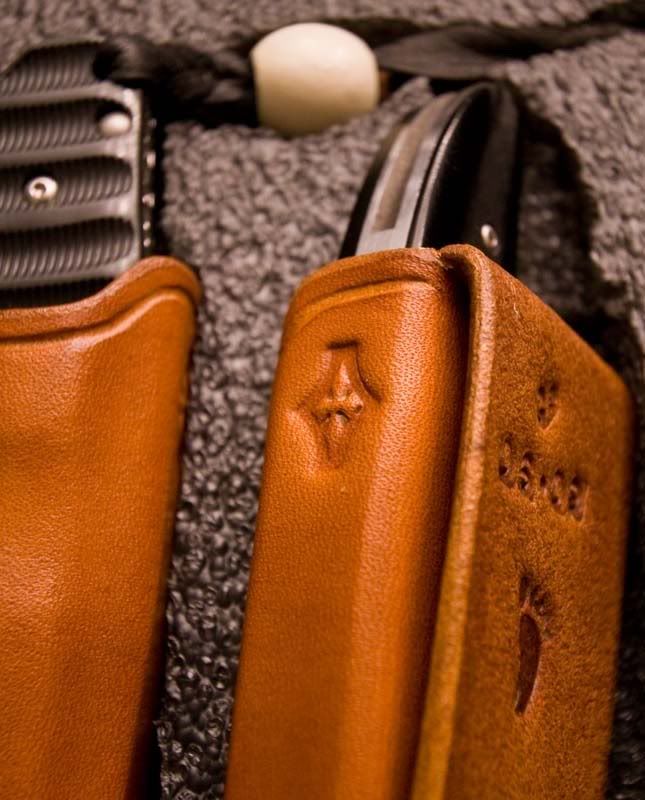

on the leading edge of the sheath I embossed what I call the North Star as
shaping the sheaths to permit the clips to stay on, didn't leave a lot for tooling.

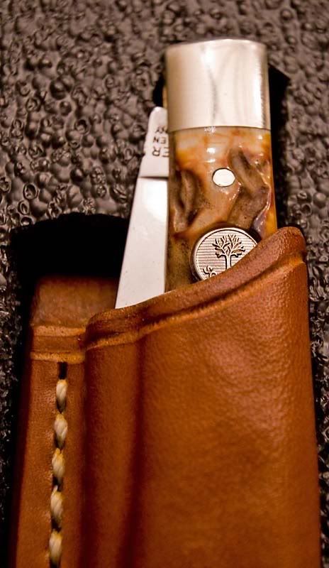

and a closeup of the Boker;

Thanks Greg and Dwayne, the way I do the forming for the clips
I make it a more soft gentle curve on the leather, formed just by
fingers and finger pressure, no hard tools for that area, so it, to me
looks more natural, I do use the bone folder along the blade edges
and around the knife itself, but rely on a softer touch over the clip
sections, this helps to leave more of the texture in the leather, as
when you press down hard with a tool it will compact that section
of leather and also makes it a little harder for the dye to sink in
because now it's a burnished area.
while I dislike clips, it helps to be able to give the person a choice
so this is the best of both worlds, able to keep the clip on the knife
but, if he decides to remove the clip, the sheath will still retain as it's
not relying on the for retention.
The Sypderco one also snaps into place very nicely, all three did, but
the strongest was the Benchmade, due to it's shapely guard area ;)
G2
