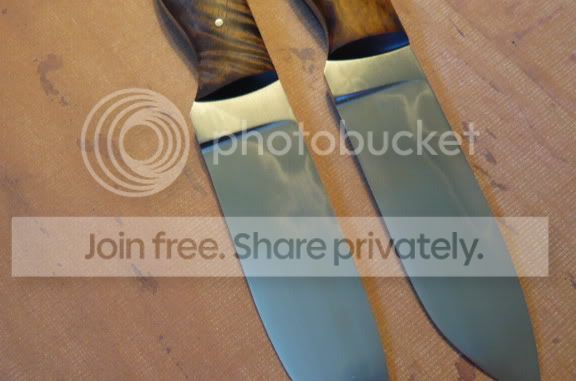

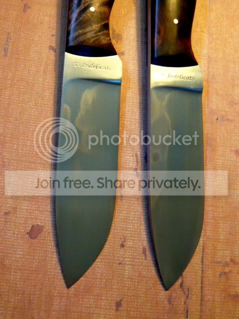

My first 2 hamons! What's the trick to getting these to show up well in photos?

Nice work, a trio of elegant knives. I like the wood that you've chosen, desert Ironwood and Koa are two of my three favorites, the third being ringed gidgee. Are you still cutting your plunges with a file?
Congrats on the hamons too, I find indirect natural light brings them out well, I play with the white balance on my camera and point it at the knife, shift the knife around, play with the camera angle, and the angle of light onto the blade, while looking at the knife through the camera screen. You'll find a combination of angle and light that will make the hamon pop. Another trick for a lightbox is to reflect light onto the blade from a black object, black plastic bag around a card or something.
Your light looks too yellow and your camera angle looks far too direct in those hamon pics.

Thanks very much, Salem! I haven't cut a plunge with a file since my very first knife that I made with hand tools. Is there something amiss with the plunges? Thanks for the photography tips for the hamon...I'll play around with it some more.

As to photographing hamons, it's all about the angle and light. Use indirect light with a dark "reflector" or dark background out of the picture (maybe in front of the knife). That tends to help bring out the activity a bit. I photograph under a window with shutters that I can adjust to bring in the indirect light from outside to the piece I'm photographing. Use an angle that avoids visible reflections. I use a tripod and adjust the angle of the knife and tripod until I get the action I'm looking for through the viewer. Oh, and no flash. Use the tripod and a 2 second timer on shots to avoid blurr with the longer exposure.
