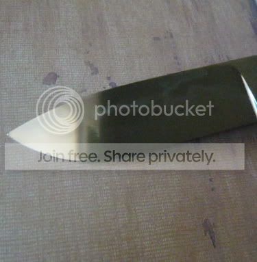

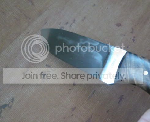

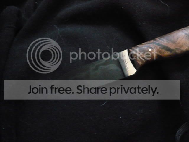

These two were with more dim, indirect light and dark reflectors and/or backgrounds. I seem to either get washed-out blurry glare or nothing with this approach:

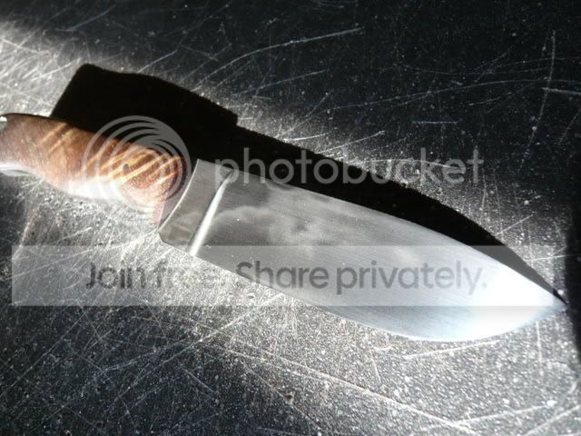

I seemed to have to physically hold the knife at an extreme angle and use somewhat brighter light to get the hamon to show itself:

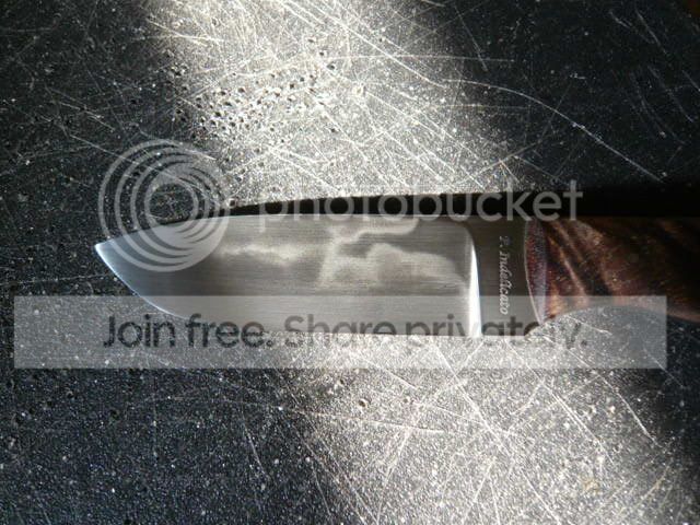

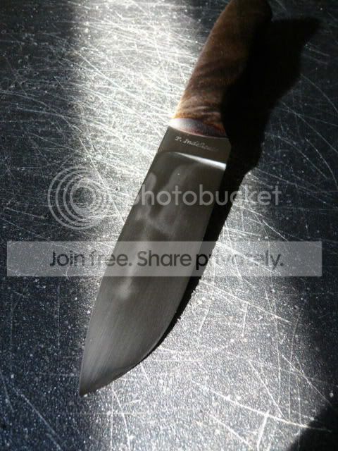

And finally, these were with pretty bright(ish) light coming from a more extreme side angle, and it seems to show up the best to me but also washes out everything else:

Yeah, they are elusive :D. I really have to re-position the knife, move the tripod, change the light, go at weird angles, etc to get what I'm looking for, and I don't come anywhere close to some of the guys capturing hamons out there. The window I use for photographing is actually in the shade, so it is really indirect. Basically, I just utilize the brightness of the outdoors, but I don't want direct sunlight coming through the window. If you've got a "beam" of light coming in as opposed to a faint brightness, you may have too much light. You also may need to increase your exposure time a bit, and you'll need a tripod to keep things crisp in addition to using the self-timer on the camera. Even the act of pushing the button will create a shake with longer exposures.
I'd say just really play with angles and with your camera setting. You'll get there, especially if you can find a great light source. And instead of holding the knife, place it on a surface, using a prop as necessary to adjust the angle, and then create the photo angle by moving the camera instead.
Keep at it, and they'll start showing up.
--nathan

Nathan, for some reason the more and brighter the light, the better it's showing up for me. Strange. OK, I'll keep playing around with it; thanks for the tips!

Maybe it's not so much the brightness of the light as it is the quality. Most photo boxes use a white, opaque barrier to diffuse the light and often reflectors to further spread it around. That's where I was talking about "beams" of light. If you've got beams coming in, you have more of a spotlight effect. What you want is for the incoming light to be spread out over the entire photo area. Take the following pictures for example:
See how the light floods the entire area? Anyway, that's the kind of lighting I shoot for if I can get it. I built a photo box a while back, but I never got it completely finished to use. Of course, keep in mind that I have absolutely no idea what I am talking about when it comes to professional photos. I'm just trying to share what works for me :D.

Paul, I was going to give you some more photo advice for hamons, but Nathan's approach is pretty much exactly what I do. I do use a lightbox for most of my pix, but when I want to get a more dramatic hamon shot it's diffuse, indirect natural light.
The thing about hamons, and everything to do with them it seems, is unpredictability. The same technique, be it quench, clay, polish, photos, will seem to yield a slightly different effect on different days. That's actually refreshing if you ask me. Once you start changing steels and quench mediums, polishing techniques etc, photos for your hamon may well act a lot different then photos for ours.
