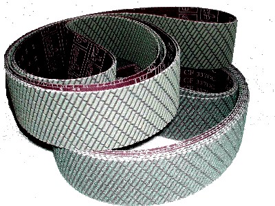

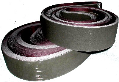

The gator has the "brick" like structured abrasives and the regular trizact doesn't have the bricks. It's continuous, and I think are what the really high grits come in like the 3k and 4.5 k
I've used the gators a bit, trizacts a few times. They both seem to work good. The gators are a bit thicker and ride a little differently, so I'd stick with one or the other on a knife as you work through the grits.

Trizact:
3M307Trizact_1.jpg]
Trizact CF "Gator":
