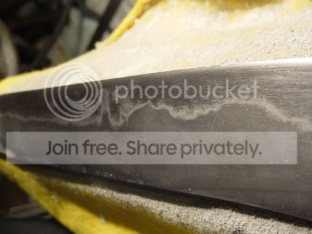

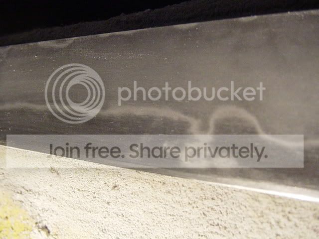

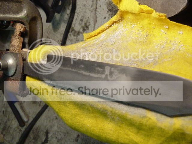

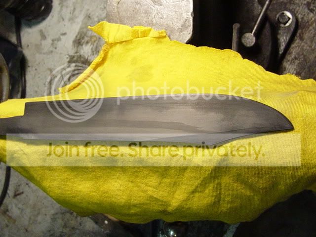

ok.. i took a little time out today... an i etched a blade and took some pic's... i know they're a little fuzzy but that'll give you an idea...
apparatus: basically degrease and etched in dilute nitric... then neutralized..
and clamped up in the vise...

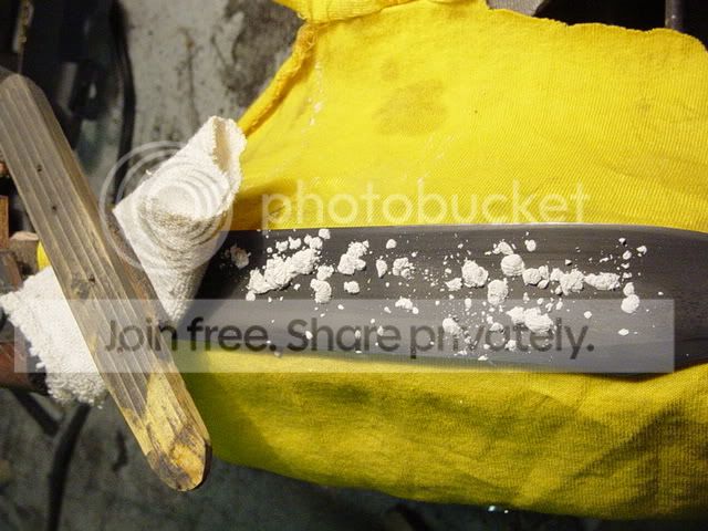

now i placed abit o pumice powder ( ultra fine ) and got my push stick with a cotton shop towel on it...

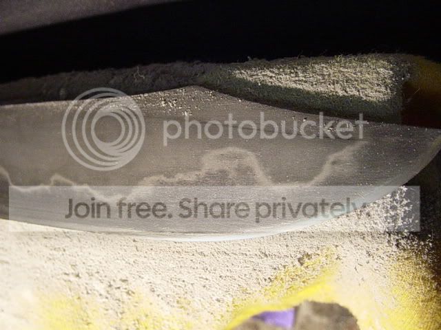

Now polish... and add pumice as you go

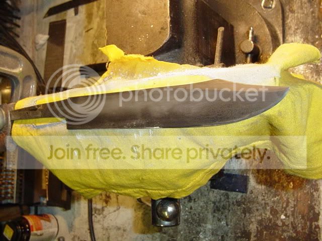

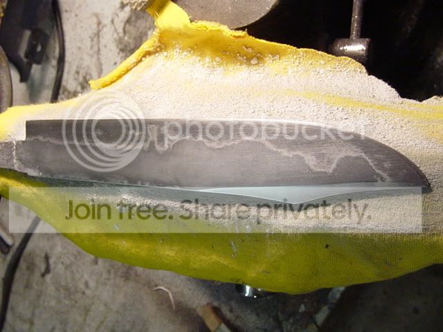

- here i'm halfway done to show the contrast...

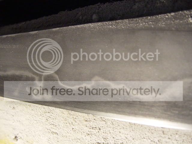

now a little more poli
oh... that was an old black diamond file.... and no clay coat on the blade.
so.. the powder does work ok... ;)
