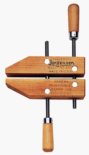

I made myself a drilling fixture from a Jorgensen wood clamp whereas I changed it to both screw handles to be on top/counter rotating, and a 2x12 pine board, which grips the blade so as to drill holes.
I'll post a pic tonite. But your right, you need to compenstate for that angle in/on the tang. I use (one of many) a small sliver of wood for that. I oversize the scales, drill one side first (put a temp pin in the first hole before you drill the second), then the second; same way. Take the two scales by themselves, stick some temporary pins through both, then sand/finish the ends that meet the guard or ricasso so the contours and angles match, then use the temp pins to pin them to the tang and finish up the top, bottom and ends. As for contour of the scale flats/sides, I just grind off the temp pins as I go, knocking/hammering them from side to side as needed.
