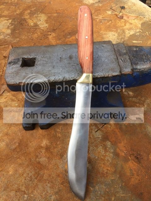

I forged this kukuri style chopper out of 1084 steel from NJ Steel Baron.

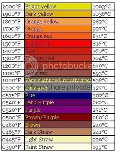

I use a Majestic brand 2 burner propane forge. I forged it into this shape and hammered in the bevel for the edge. I normalized it three times to allow myself to be able to drill the holes for the handle. I then heated it to 1500 degrees in accordance with this chart:

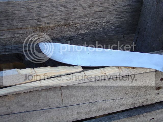

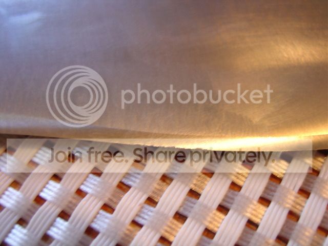

Here's where the problem came in. I chop tested it one time against a board from a pallet. As you can see it in the picture, I got considerable damage to the edge.
The picture us fuzzy. Is the edge chipped, or deformed? If it's chipped, temper at 450f which should drop it 2 RC points. How thin was the edge before you sharpened it, and what angle is the edge sharpened at? It may be a geometry problem, not just a heat treat problem.

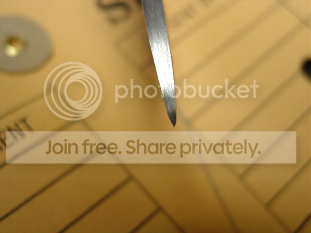

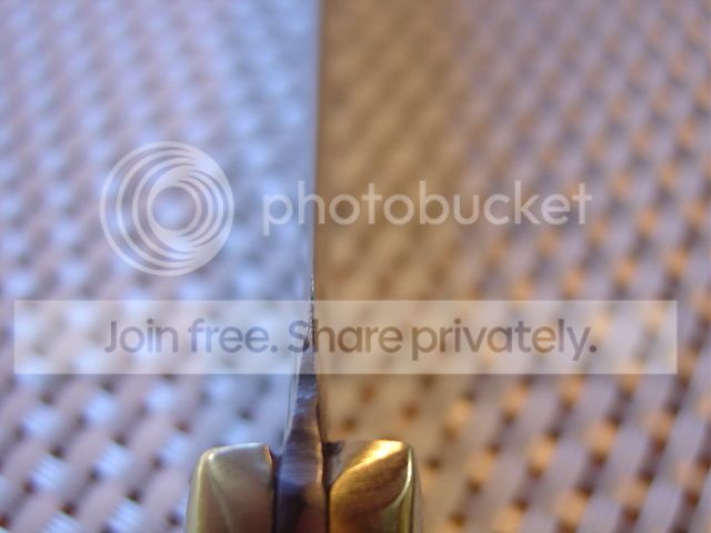

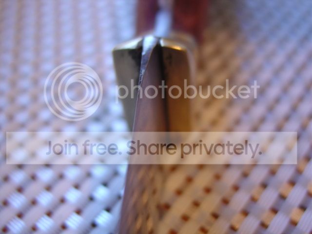

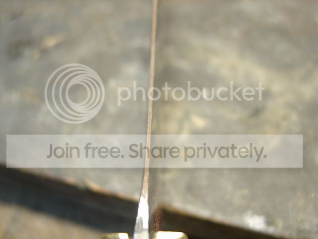

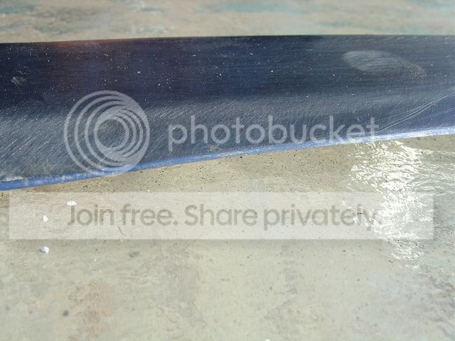

Thanks for your response. Sadly, I do not yet know enough about blade making to tell you the geometry involved. Here are some pictures that I hope are helpful.

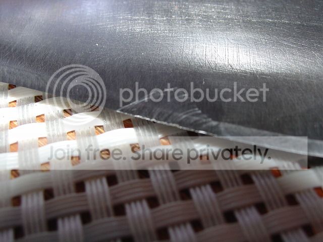

Here is another picture of the damage. It is not what I would call chipped.
If pieces of metal broke off the edge no matter how small, that's chipped. If it's just deformed from the edge bending back in spots, that's not chipped.

3) The edge shown looks far too thin and low angle. A chopper should have an edge angle of about 20° per side or even higher for a rough use chopper.
The quench and temper are done, and are what they are. What you can still do is change the edge. Grind it back just a tiny bit to a small flat edge again and sharpen at 20° per side. I personally use a convex edge on rough use blades, where the edge is sort of rounded down from the bevel. The angle is still the same, but there is a bit more meat above the edge, making it more durable.

Never trust your eyes to guess the temp of steel, depending on the lighting you can be way over or way under. A more reliable gage is using a magnet. Heat slowly and keep checking if the magnet still sticks. Once it stops sticking your very close. Just need to go up 75-100° from there and quench. The problem I gave found with trying to eyeball temp is your eyes will adjust to the brightness and give you false results. If you look at the steel for the first time it will look bright but the longer you stare at it in the forge the more you eyes adjust to forge brightness and things get wonky.

Get a set of calipers from a hardware store. I use the dial kind. Measure the edge thickness before you sharpen. For a basic forge, eye calibrated heat treat, leave 0.025-0.030" before sharpening. Then put a 20-25 degree per side edge on it.

Folsoml, it's a nice blade you've made. Do what they said & you should be fine. If you can measure BTE thickness prior to re-shaping the edge, I'd interested in knowing what your edge thickness is now, since it looks to be very thin. Once you get closer to .025-.030 you should have a good chopper blade with what others have said & a steeper angle for the bevel.
Can you measure the edge as it is now & let us know what you started with?

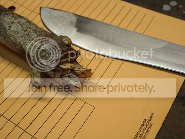

I ground the edge back down to a flat surface.
I then put my best approximation of a 20 degree edge on it (not symmetrical I know. I tried to build a jig without much success. I just ordered a store-bought one)
I then went around my back yard chopping various things until I build up my confidence enough to chop through this dried oak limb.
When it took that with no damage, I returned to the original pallet. One whack at it did the original damage. This time I chopped all the way through the top board.
No Damage!
Looks like your HT turned out pretty well for a blade this size. With the thicker edge & different angle, it seems to be working as it should & cutting very well now. Without a real test of the blade, you can't know how hard it is, but it seems to be hard enough to maintain the edge & tough enough to not chip with what you're cutting.
