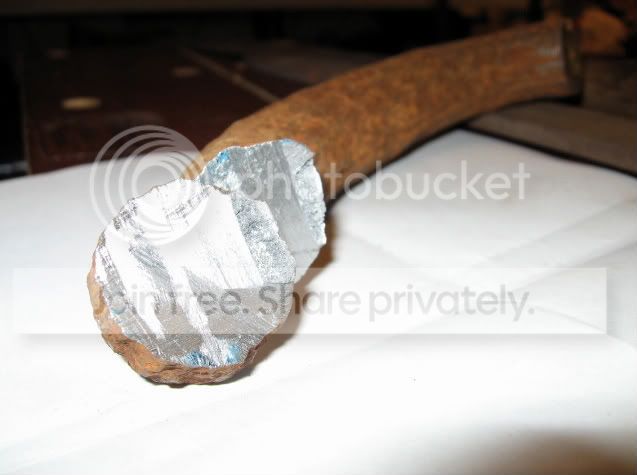

WI looks like this when broken. Unless it is refined
This is anchor chain I have and know it is WI. When broken does not look much different from yours
Dave, Do the cut and bend test again but this time leave a 3/16" to a 1/4" uncut. To me it looks like you left to much uncut and it just snapped off. Bend it slowly and I think your results will look similar to the picture Stuart posted. Just make the cut from one direction. Don't do an under cut.

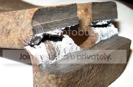

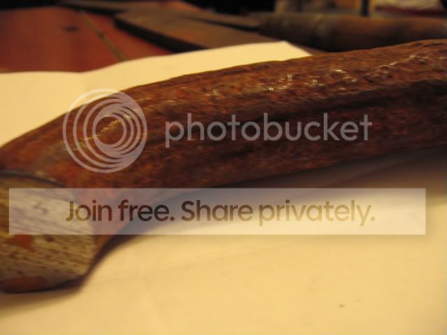

I posted a "how to" thread a while back on wrought iron and how to tell if it was. here are the pictures from it
close up of forged wrought iron chain.
look how perty

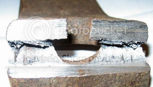

cut with a hacksaw.
open it up.
This is what you want to see, this means its the good stuff
