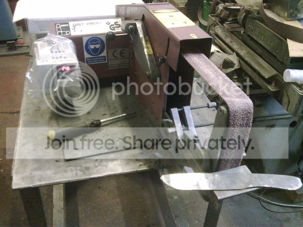

I welded a piece of heavy angle iron to my Wilton clones frame a few years ago, with a couple of holes drilled in it to take the front assembly. This lets it run 2mtr / 72" belts, best picture I can find, sorry, but it gives the idea!
