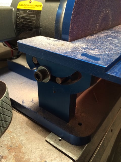

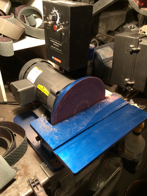

Not much discussion about disc grinders because most of us make them . I did too . I had a 1hp variable but it only spun in one direction . I use a disc to get things flat . The platen is ok but I feel the disc is way better for me anyway . I decided I wanted a better disc sander . I thought about Beaumont Metal works a 1hp variable with reverse and I wanted the table. I also looked into the Tru Grit and the Hardcore 1.5 hp . I went with the Trugrit pretty much on price . But I was very concerned about the lower hp on the one I purchased . It was the middle of the road at a scant 1/2 hp .
On my home made one it stalled very easy . So I assumed either the conversion with the cheap variable drive was bad or I may not have set it up right .. Who knows I am not a electrician .. And I really can't remember things like I used to so I just leave that stuff to the pro's .
I got my disc . Sadly it didn't come completely set up with the wiring installed or even a plug . But they did ship that stuff out fast and were responsive and were a little embarrassed about it . I have wired my KB from when I got my KMG so i did it and was very easy .

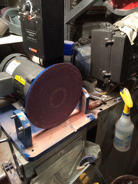

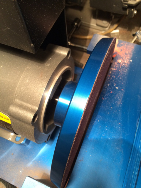

Now on to my concern when I bought it . The 1/2 just didn't sit well but I tell you it has all the power and then some . It can be stalled but only at low but not even close to as easy as my previous one . The table is something I really wanted and I am already using it . On to the disc . The disc is way different than the KMG . It seems a lot heavier .. It also has a nice little bevel At the top . Not as slick as Nathan's but a lot nicer than my last one . It has no vibration at all and doesn't even want to walk on the table in bolted .
So I'm my humble opinion I really like this and I am glad I got it. Granted I didn't have the option of a side to side with Beaumont's and I am sure his is very nice . But there is a difference in price . So that's my take on this . I enclosed a few pics .
Marko3, That looks like a very nice disc sander. The table looks really well made and with a hex wrench handy it should be quick to tilt for dovetailed bolsters and the like. I use a Beaumont table but it was expensive although very well made. Your disc should do everything that a knife maker needs. Larry

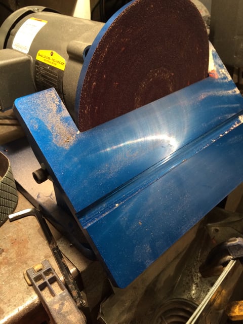

I am glad to hear some other guys are using this . I had some good use out of it today . I just picked up some knobs so I don't have to break out the hex everytime I want to adjust it. I put a 30 degree bevel on most of my fixed blade handles . before I had to shut down the KMG and adjust the platen .. not really a big deal but the disc is sooo much easier and a little more precise . I will be able to dove tail quickly . I do wish I got one of Nathans but when he had them for sale I had just spent money on something else so it was a no go !
