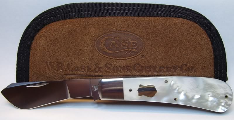

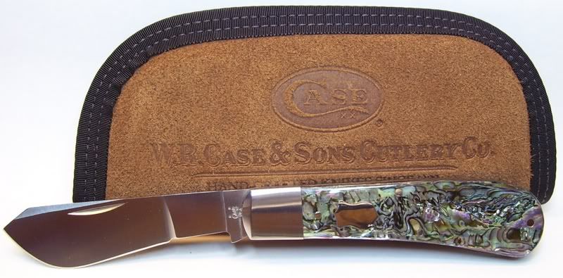

Man talk about timing!!! I have not seen this topic until today and guess what Mr. FedEx just happened to drop off at my house today.:D
Here is a link to what has been released in the Case/Bose Collaboration Knives.. http://www.mchenryknives.com/collection/index.html
I have been smitten by these baby's...:rolleyes:
