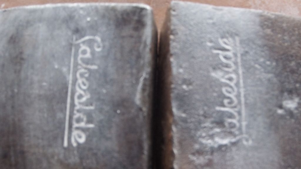

Nice Lakesides. The cursive script is maybe newer than the more "normal" on the hatchet?

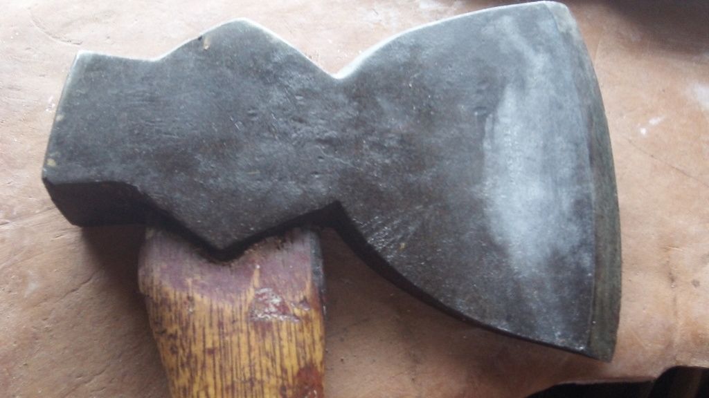

These are those Lakesides I was talking about in other thread. I had thought they were made in Oregon in Klamath Falls due to what I found on another thread. I saw another thread as well that says some Lakesides predate 1830. I don't know how accurate any of that is. The script writing on the Warren and the Eclipse do seem quite similar. I did use chalk to try to pull the stamps.
Your just swimming in Lakesides!:thumbup:

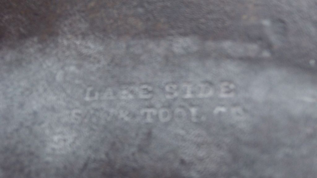

I don't thin k I have seen the Lakeside stamp that is on that hatchet before. I can't read whats below the Lakeside. Is it "Saw & Tool Co"? Good looking hatchet!
Yep Lakeside saw and tool co, and Thank you for that. Oregon does have a bunch of these. The Forest King axes are numerous as well.
Sluicebox, I have been looking around on the internet and I don't know if that hatchet is related to the Montgomery Wards brand "Lakeside". I wonder why it is spelled" Lake Side" instead of "Lakeside" on your hatchet as everything I have seen on Lakeside Saw & tool Co, Lakeside is one word. The smith had limited education probably.

I'm thinking that broad hatchet was one of their early ones, made before they were picked up by Wards. However even in that listing I reference above Lakeside is one word just as you state.

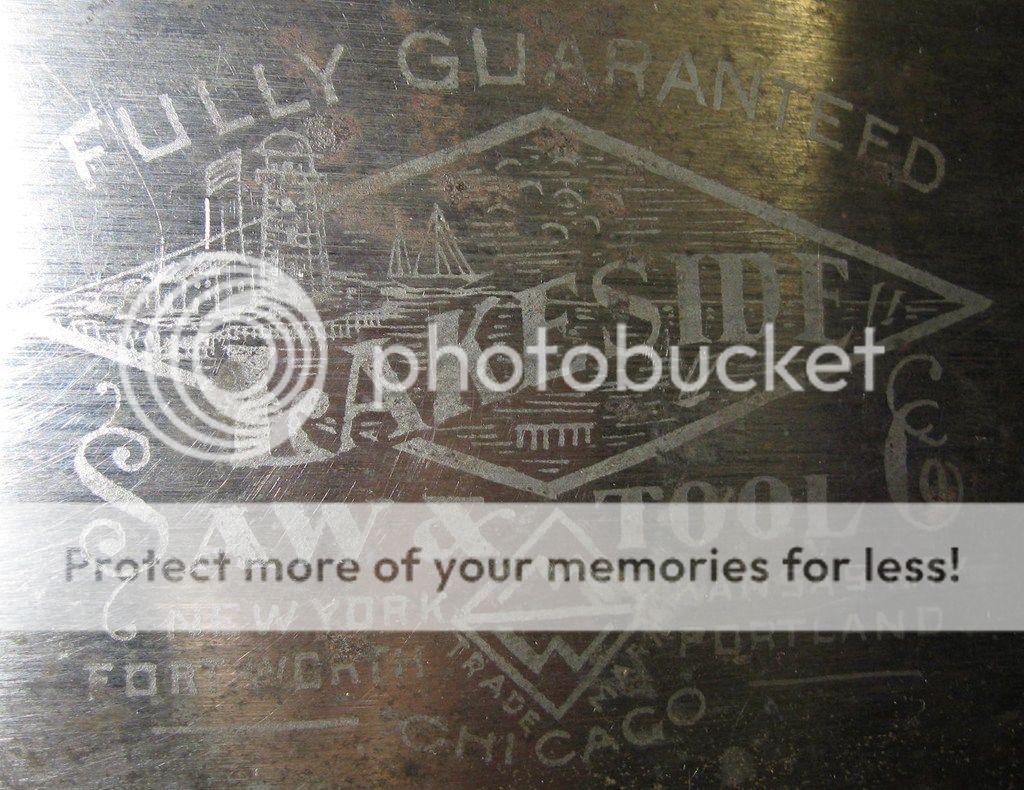

So why am I interested in Lakeside and Montgomery Ward? About a week ago I also got a Lakeside axehead with the cursive script. But I really got started a couple years ago when I acquired a Lakeside MW backsaw.
I believe the etch is an early if not the first etch by MW for a Lakeside saw.
The plot thickens, excellent links thank you. I'm gonna really dig for that Oregon link to Lakeside. . .
I think the cities on the etch (one of them Portland) were MW manufacturing sites. What ever they were it might help with Oregon connection.
I think this could be possible.
Very nice saw! With the M&W trade mark. Maybe finding when Montgomery Wards first opened offices in New York, Kansas City, Fort Worth and Portland might put a date on it?

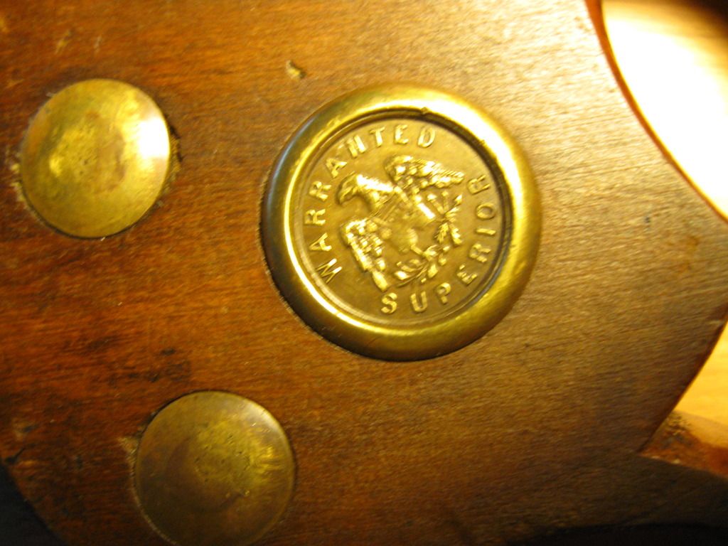

rjdankert, If that is a carpenters saw I would be very interested in knowing what the medallions say on them.
It is a 14 inch back saw.
The nuts look original, but you can never be sure. The medallion is what I would expect on a saw sold by somebody like MW.
