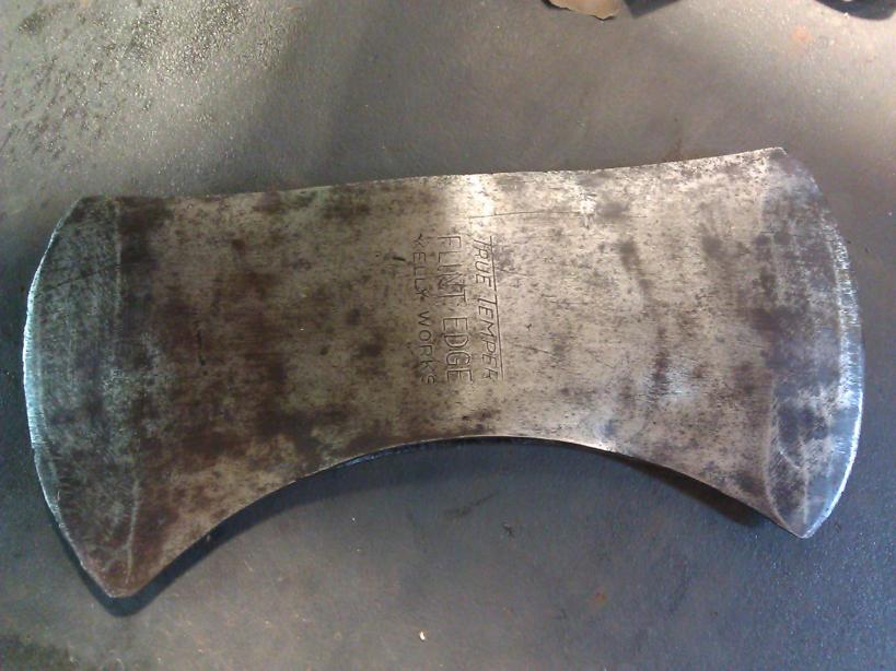

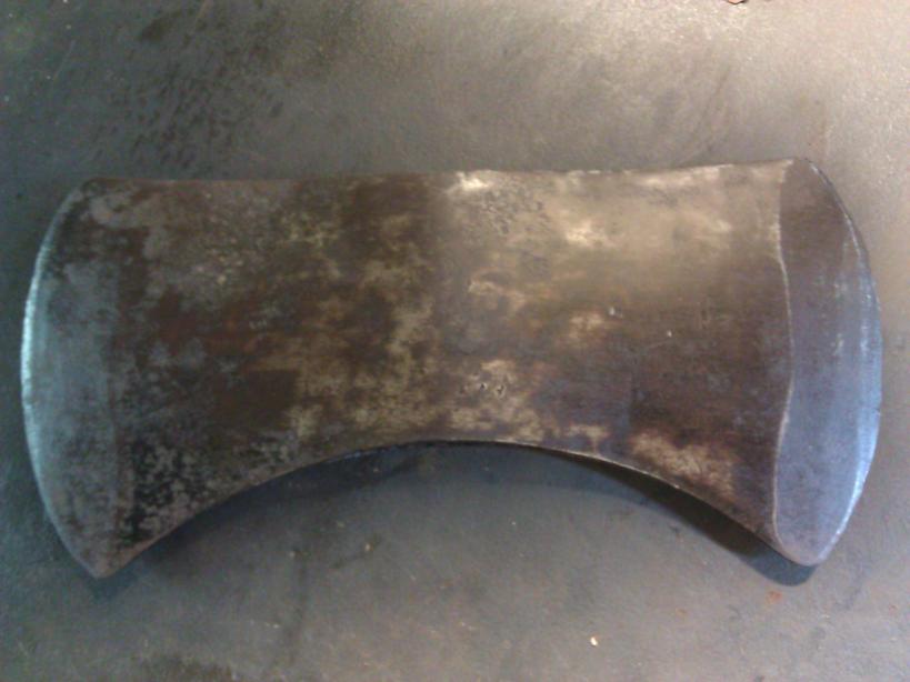

Ok, I'm opening a new WIP thread on the one I picked up today (from the followed-me-home thread)
As received, dirt, electrical tape, and all:

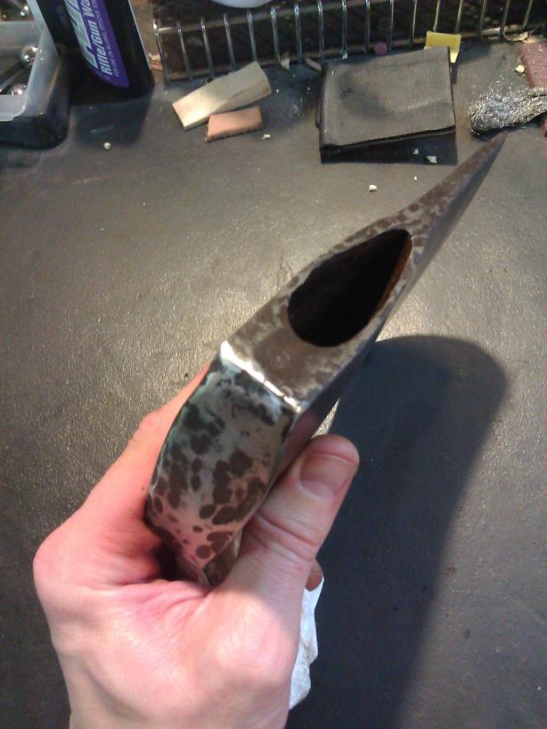

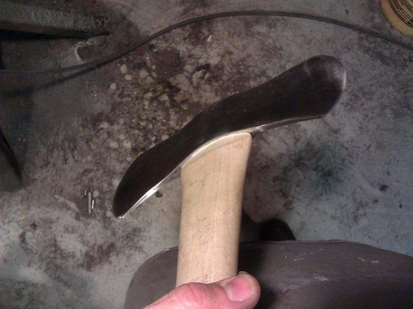

This evening I cut, drilled, and pounded out the old handle. It was in surprsingly good shape, but I couldn't brook the two nails in the eye and the beaten shoulder. The grain of the handle is about as perfect as it gets, alignment-wise. The toe (toe?) of the handle had a chunk missing. I'll trim that smooth and turn this into a single-bit handle for something else with a small eye, like a hatchet. It's about 22" long now.
After some steel wool and scotch-brite I just said f*-it and grabbed some 180grit scraps from the knife sanding area. I used a bit of 9oz leather scrap as a backer for the paper. After a wipe down of the progress so far, I wiped it with Ballistol to keep the rust from coming back.
Side A:
Side 2 - still needs work, I got bored since there are other things calling:
I'm reasonably happy with this dirty finish on side A. We'll see if that changes... it might get a real brushing if I get retentive about it. Side 2 has to come up to match at least. There are plenty of chips in both edges, but I've got an app for that... sharpening will happen last if patience holds.
The head measures an even 3.5lb on the trigger pull gauge.

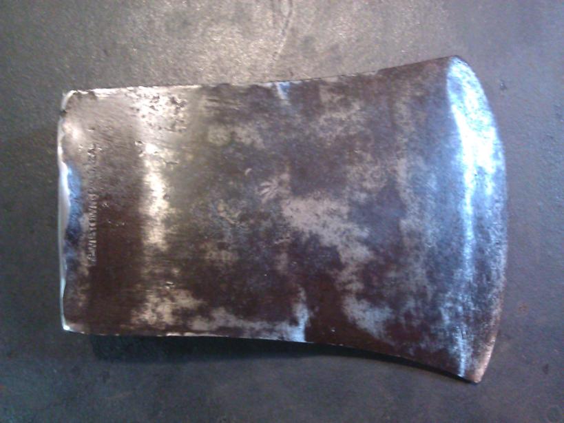

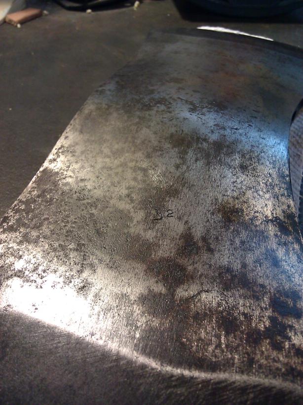

Tonight I cleaned up the back face of the TT to match the front:
it's marked 3-2 on the back:

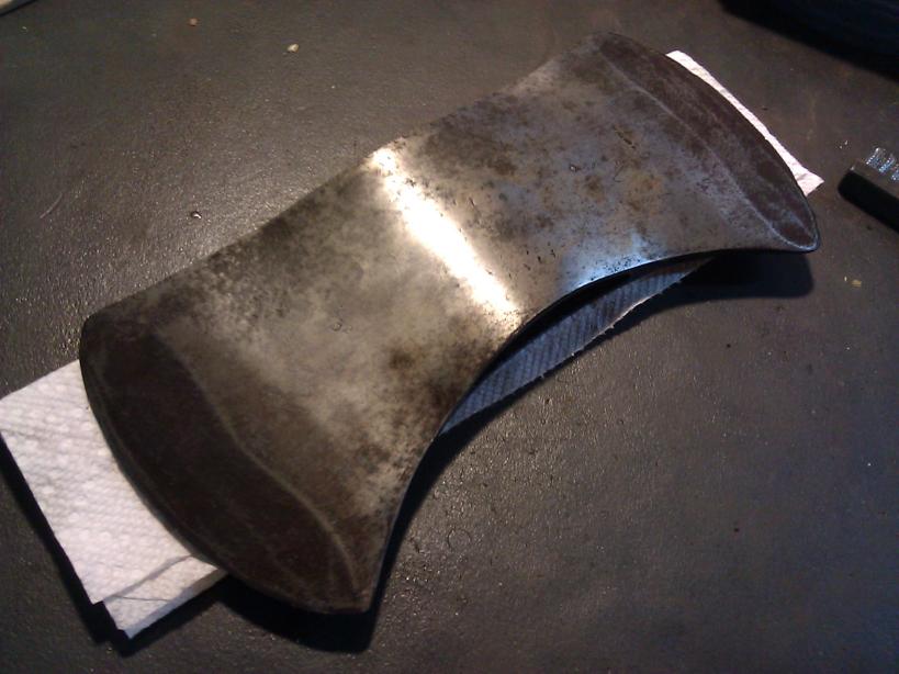

Also knocked the rust off the Mann - apologies for the low light pix. It would be a bit of grinding to remove all the mushrooming and get the dings out of the poll, so maybe I'll leave it alone.
They are both now in a state I'd consider handle-able, minus edge work.
Debating trying to even out the finish on the Mann with cold blue.

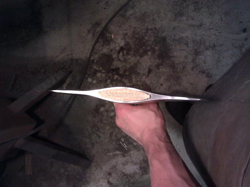

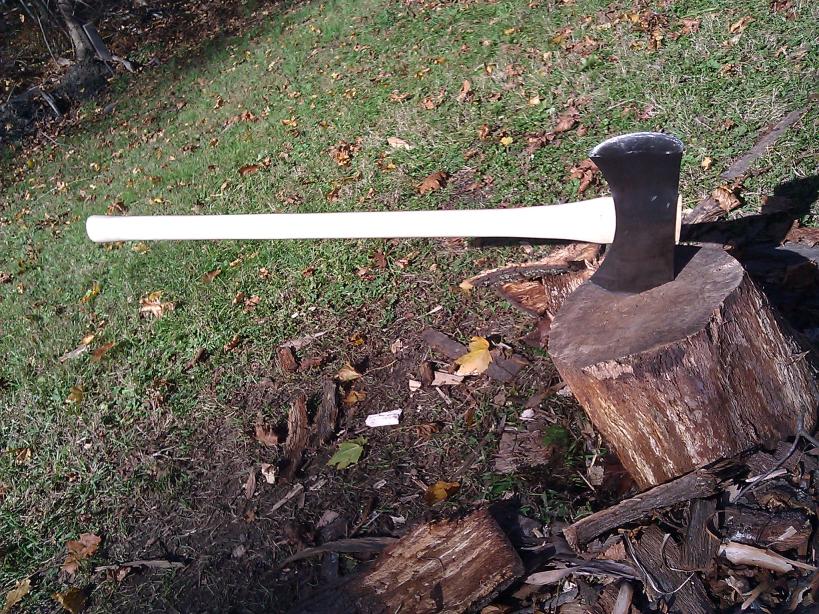

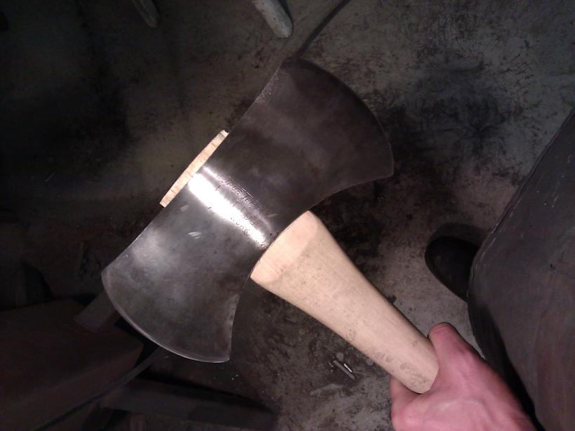

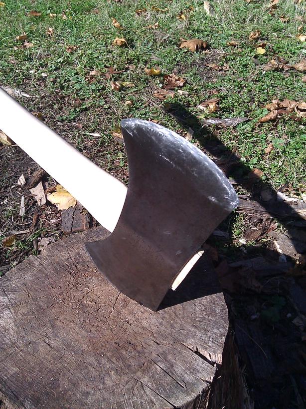

Tonight I brought the Kelly True Temper Flint Edge to Rock'n'Roll Knife & Tool, figuring I'd rough-shape the handle on the KMG and then hang it at home. Of course you know what happened... couldn't stop 'til it was done.
Before knocking it onto the haft I reprofiled the edge on the slack belt running in reverse. grind/dip/grind/dip. Barely got warm to the touch. Then I ground smooth the top and bottom of the head, removing the original ugly grind/tool marks. Finally I cleaned up all the surfaces with a scotchbrite belt. It needs about 10 minutes with a hand stone now and then it's good to go.
I thinned the wedge so it would drive a bit deeper - probably could have thinned it quite a bit more. It also got some wood glue in the kerf this time. We'll see how it... uh, hangs.

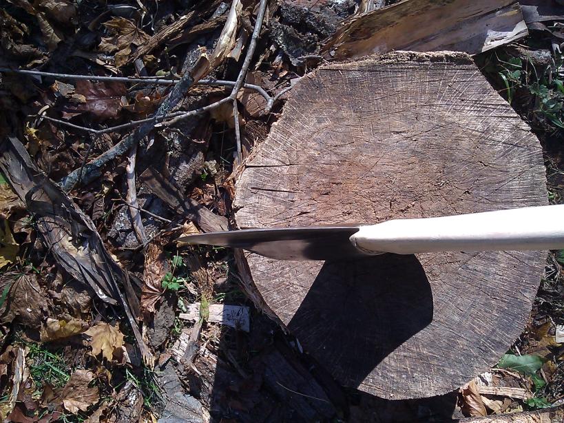

This axe ranks up there among belt grinders, bandsaws, and chainsaws as among the scariest tools I have ever used. I cut my finger on it while sharpening it on the stones before even going outside. Good news is it has a serious edge. Bad news is the damn thing is edges all over! There is no safe way to carry such a tool, and a sheath of some kind is a must.
That said, it chops like a deforestation demon!
It's too thin to make a good splitter - tried that first. and pulling it out of a stuck log is harrowing since the back edge comes right atcha. This makes me happy as I already have a perfect dedicated splitter. Chopping, on the other hand? O.M.G.

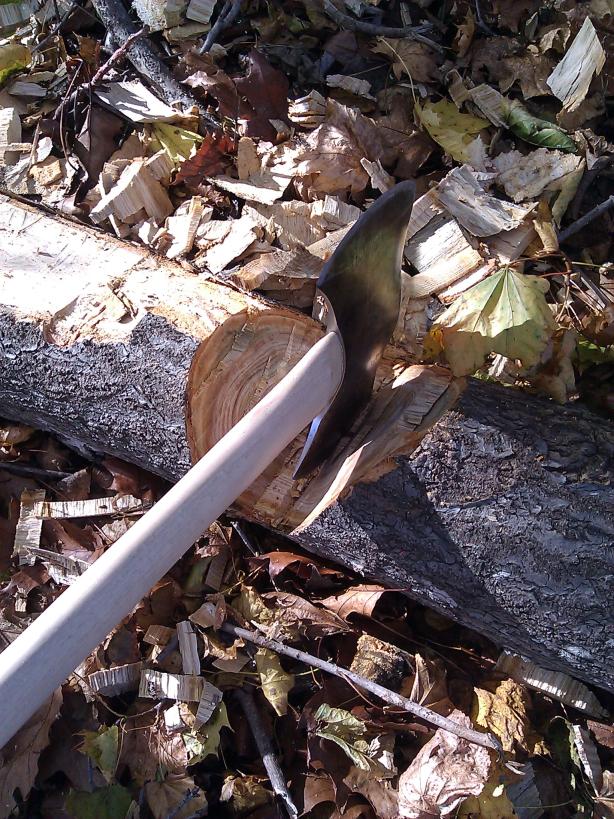

This thing is riduculously accurate, even more so than the others. Presumably this is due to the balance and straight haft. It cuts where I look. Just have to focus.

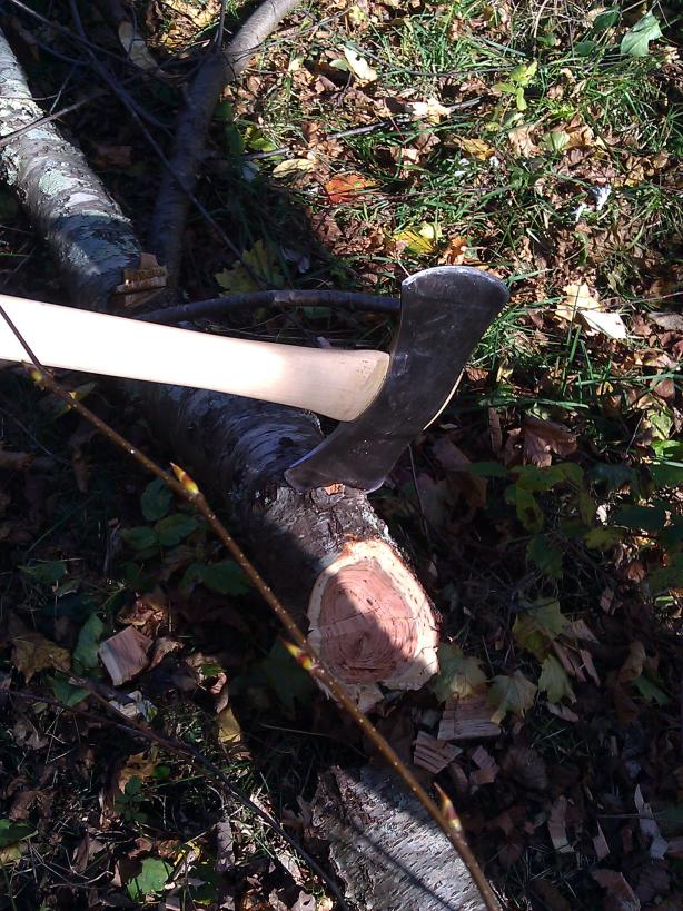

Before (note the efforts of three other axes to the left):
After:
And the 4" limb that was so much work with the 1.75lb Warren: just a snack for the Kelly.
