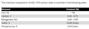

fwiw, incolma uses 'sae 1070' steel, a pretty good choice for a machete, and I like it much more than the typical 1055 you'll find in cold steel and other low cost brands
also, ontario and condor use 1075 most often for machetes - also an excellent choice
share your project idea? : )
I was under the impression that Incolma uses 1074 or 1075 as I believe does Imacasa. It's Tramontina that uses 1070.
I think you're right, they are almost the same - 1070 vs 1075... I think 1070 has slightly more (0.2%) Mn than 1075
both are nearly perfect for low cost machetes

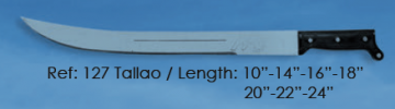

I got some 18" versions of this when BUDK was selling them. They are thin.
I'd prefer something like this, but haven't seen them sold in the U.S. EDIT: Oops, I thought it was a thin version. It's a regular #127 just partially hidden in the packaging. I have some, LOL. BUDK.
I think you'll find the Caguayano quite thin with distal taper. Tramontinas that I have do not have taper and are a bit thicker. Here's a Bellota machete similar to the Caguayano. Note how flexible it is.
