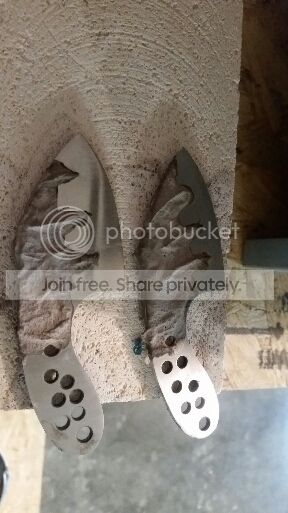

I have been wanting to try a hamon for a while.
Finally have everything in hand to try it. Well, everything except a p.i.d. for the kiln.
Steel:
1095 and w2, both from Aldo
Quench: parks #50 from Maxim oil
Coating : Satanite from high temp tools
These are a couple of little skinner knives I make. My friends that hunt love them.
I put an initial grind on them, and pretty much followed the thread here by RyanW: http://www.bladeforums.com/forums/showthread.php/997744-My-Hamon-Process
After profiling and drilling holes, I took the bevels to 220.
Washed with soap and water, and mixed and applied the satanite.
I let it sit for a couple hours, them put it into a toaster oven for about 30 mins to make sure it was dry.
