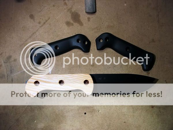

Hey guy's, Here's a photo of my BK2 handle project. I'm making the handle out of red oak, that's the only thing I could get locally. I'm going to order some cocobolo soon but thought it would be cheaper to do my first inexperienced project with this. I'm using hand tools for this project, as you can see I have rough fitted the scales to make sure my holes are aligned and everything fits good, next I will remove them and drill my lanyard hole. Then I will profile the contours to match the originals. I am open to critique and helpful tips.

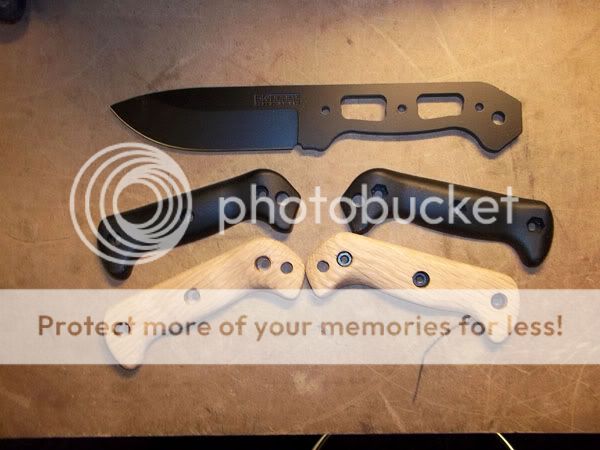

I'm going to stain them after I finish profiling them, Here's the first profile, now I have to sand it.
Looks nice. How much time do you think you've invested so far?
~3 hours so far, going slow as this is my first handle creation. Also using hand tools is a slow go but I like hand tools and they don't make so much noise in the house and that keeps my wife from screaming at me.

Once you get the holes drilled and milled out and everything lines up, the hard part is over.
I don't have how-to pics but the tools I used are: bench vise,coping saw,wood rasps,brace and bits and sandpaper.
When I first started I was drilling 1 side and then the other and had a bitch of a time keeping them lined up. Now if I have 2 separate pieces I glue them together before I do any drilling. They line up that way. Every time.

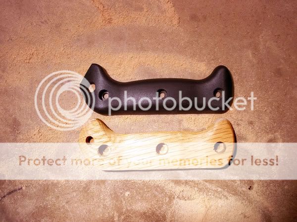

OK, I finished profiling and sanding, now I have some minor touch ups and I'm ready to stain. Don't know if i'm going dark or light though.
To get mine aligned I carefully clamped them together with leather padded vise, and it worked out good. There are definitely some things I will do differently next time. That's how I learn though....trial & error. Now I need to order a BK9 and by the time it gets here I'll be finished with this one. I'm going cocobolo next time though, that's some pretty stuff to me.
