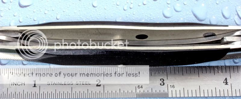

For your stated conditions I would purchase the black valox sawcut scale knife. It will be the most 'bomb-proof' of the two mentioned. Heres why - they are both pinned thru the bolster equal in materials. However the the Dymondwood scale is only pinned to the liner with two rivets. The sawcut scale is hot pressed onto the liners and there are extensions of the scale that go thru holes in the liners and then are hot pressed into sort of a rivet head. On the shield scale , the traditional Buck knife, bolt and hammer shield is formed as a pillar of metal from the liner, and that scale is not only hot plastic riveted but hot 'pushed' down over that pillar. I have taken both types of scales off to rescale with wood and the black sawcut is the very much harder to remove. I will include some photos so you may see my descriptions. I enjoy the carrying of the new plastic yellow scaled 301/303s but they are riveted on the liner like the Dymondwoods. 300Bucks
Front scale inside. Only three plastic rivets due to shield pillar
Reverse inside, four plastic "rivets". On the inside these plastic melted head rivets are formed in a depression the size of the plastic head shown with a smaller hole actually drilled thru the liner.
Shield pillar formed on liner, here you can also see the spring rivet goes all the way thru. Notice how I struggled with hacksaw blade wrapped with a tape handle in cutting away plastic of scale. To the right of the shield pillar is the actual hole the plastic rivet passes thru.

As far as a recomendation on purchase I will defer as I am aligned in a certain way, I will count on other forumites to influence you....listen to experienced users here on the forum that use their folders in the field. I will however make a recomendation on WHICH 303 to purchase, if you should decide to.
