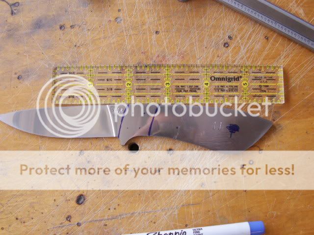

Okay, It has taken quite a while but I have blades picked out for the tumble after I get em back from HT, they hopefully go in the mail friday or sat to Mr Bos. I have settled on this lineup for handles. Walnut burl guard, .02 brass spacer, and ipe handle. The parer, and the skinner that looks too big to be a skinner, and the slicer are going to be a 3 knife set, all same handle. The smaller skinner is going to get a silver twill guard, .020 stainless spacer, and black G10 handle with one 1/8 stainless pin. I took the pics so I have a reference for the shape I want for the front of the guards, and I was marking spots for pin holes, hidden and exposed. Although after looking at the pic of the slicer, the curved shape on teh guard looks kinda nasty with the flat clean ricasso bottom. That might just be straight lined after all. If I had the room, it would get a 9 inch diameter plunge, but I cleaned up the ricasso before I finished the plunge. Dont ask me why, who knows.
