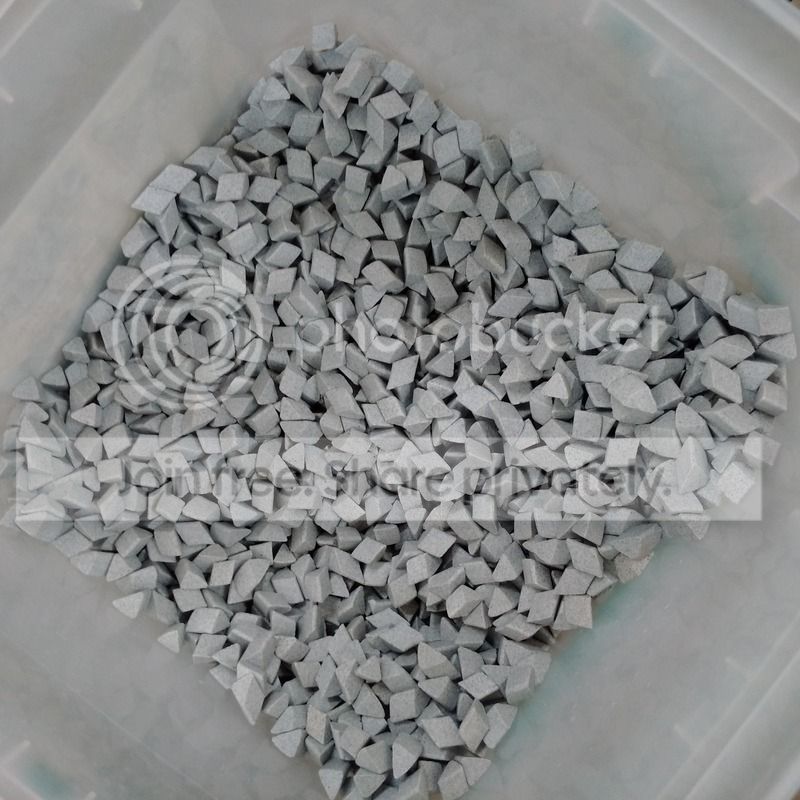

I bought 20lbs of aggressive cut media on eBay. The finish doesn't look too bad, but I would like to get some less aggressive media and try a two step process.

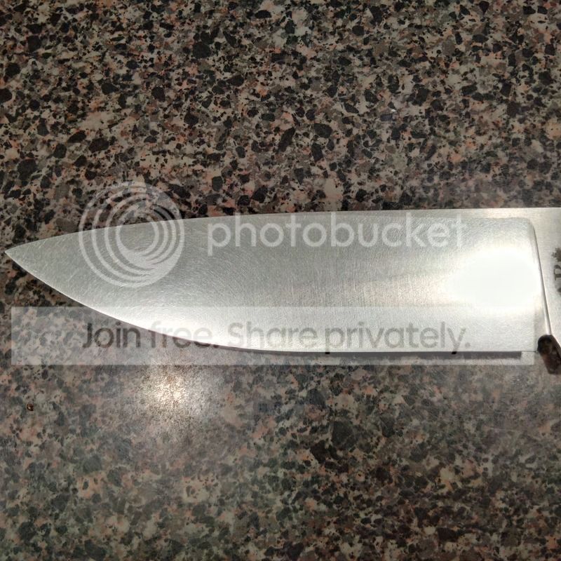

This is after two hours of tumbling. It's hard to take a decent pic with a cell phone but you can barely see the grind marks under the finish if you look at it a certain way. I covered over the makers mark with nail polish as I tumbled this one with the handle on.
It was pretty shiny and I thought it would probably scratch easy so that is why I decided to try tumbling it.
