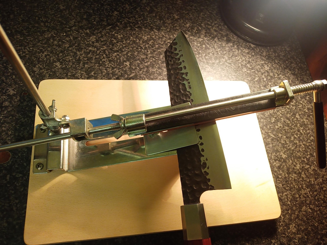

I got a good Chinese guided sharpener called a Ruixin Pro-009 for the Dragon at Christmas and she`s not even opened the box yet plus I have to do her fancy Jap knives myself and she won`t touch carbon - she was supposed to learn to sharpen so we could help the various poor souls who think all knives can be done in two ticks with a crappy pull-through sharpener.
