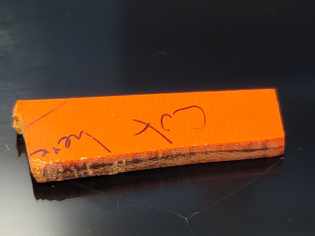

I am working on making some G10 scales for my sons very first knife. I picked G10 mostly due to its durable nature.
I will be finishing shaping the scales tomorrow. I was thinking about texturing the grips. i dont have access to a media blasting cabinet but I do have access to a stainless media tumbler.
Has anyone attempted tumbling G10 before? If so how did it come out and how agressive was the SS media?
I am going to tumble a test peice tomorrow and will post the results assuming it works at all.
OK, so to start answering my own questions. No, G10 does not float which is great as it will allow me to attempt to tumble a sample. I have the G10 in the tumbler as we speak.
Here are the before pics. I will post updated images tonight once the G10 has had time to tumble.

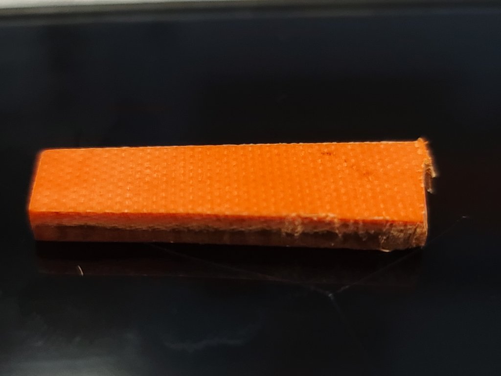

I may have to try some, after 8 hours of tumbing with SS pins the G10 was clean but otherwise totally unaffected. So, the moral of this story is tumbling with SS pins does nothing besides knocking off the loose fibers and polishing G10.
I've done quite a bit of scale work about 10 years ago. If you want a grippy feel to G10, skip the tumbler and opt for an aggressive media in a bead blaster. The closer you get to the G10 with the nozzle and the longer you dwell on an area will open up the softer resin and expose the fabric.
