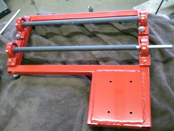

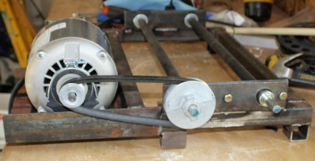

I think this guy has solved your problem......................
The plan and more photos are here:
http://www.ar15.com/forums/t_6_42/344986_How_i_built_my_own_rotary_tumbler.html

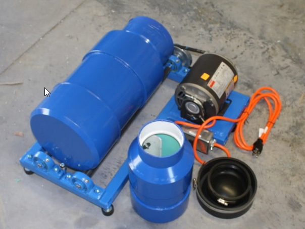

That machine is a little on the small side unfortunately... I build a tumbler similar to that a while ago, but it was direct drive rather than belt driven, and that meant I couldn't get the speed low enough while still having the power to turn the barrel.
I think I'll be making something similar again but using a reinforced 5 gallon pail this time. Not 100% sure yet though. The other option is to buy the smaller vibratory tumbler from Northern Tool.
I made this one a few years back with a motor from a treadmill, a variac for power and a bridge rectifier to convert AC to DC. I used 4” pvc pipe but with the torque that motor puts out you could go a lot bigger on a build.IMG_4007.jpeg
