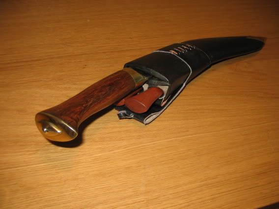

The fist thing was to sand off the handle rings. They felt very uncomfortable in my hands. I also changed the shape of the upper part of the butt; it feels less restrictive in chopping now. The polished handle feels great, but is a bit too slippery (more on this later):

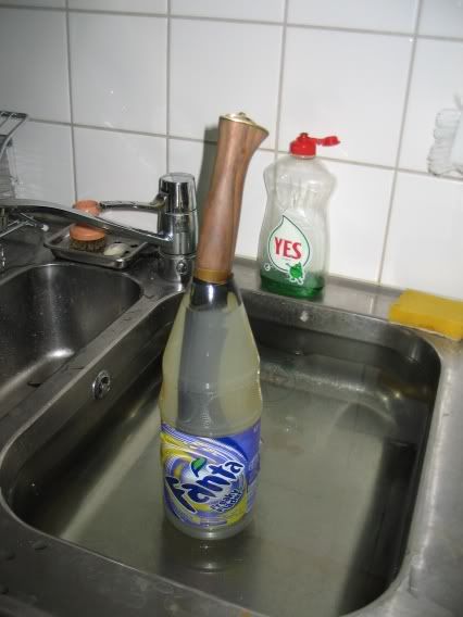

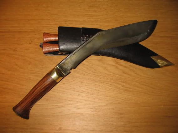

Next, I removed some small scratches and kinks in the blade and straightened and deepened the blade grooves using a Dremel and some needle files (they’re still not perfectly straight). This took quite some elbow grease… I etched the blade using vinegar in a plastic bottle (heated by warm water in the kitchen sink). I also removed the cho – this was a tough decision, but I prefer the functionality of a choil (I also removed a potential stress riser (?)).
The result:

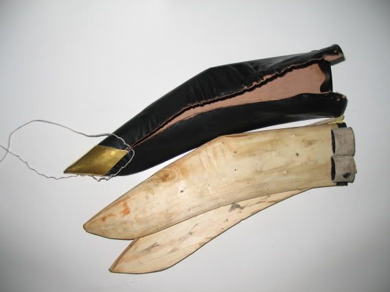

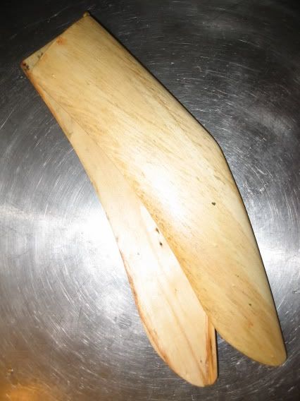

Removing the leather from the wooden scabbard slabs was easy, I just pulled out the nails and removed the thread that held the stitching in the back.

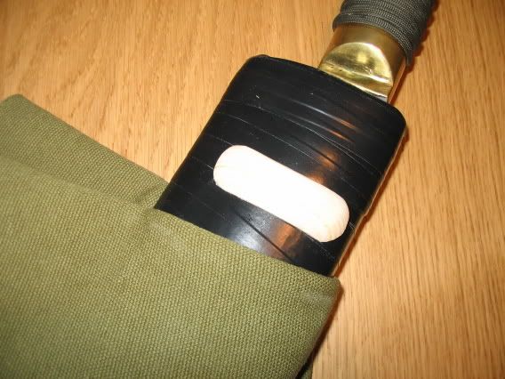

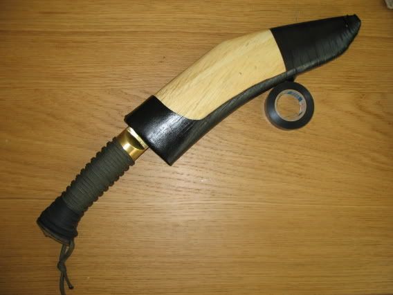

The sheath slabs were sanded and impregnated with varnish. To hold them together and to increase the water resistance they were covered with electrician’s tape. A strip of the original leather was left to protect the edges:
A small piece of wood was applied to the front of the sheath to provide extra grip purchase for the belt frog.

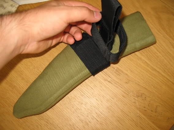

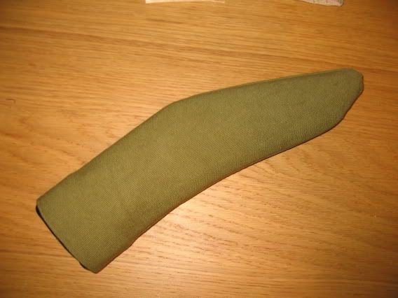

A piece of green canvas was folded over and fitted to the scabbard. The edges were marked and then sewn on a sewing machine. The sock-like covering was turned inside out (to hide the stitching) and pulled over the sheath:

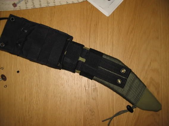

A piece of a cordura shoulder strap from an old backpack was turned into a belt frog for the sheath. My girlfriend had to help me with the sewing because I didn’t get along with the sewing machine. The frog is constructed so that the knife can be worn either horizontally or vertically.

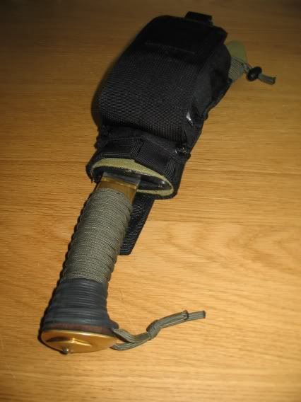

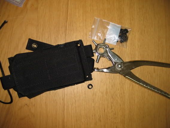

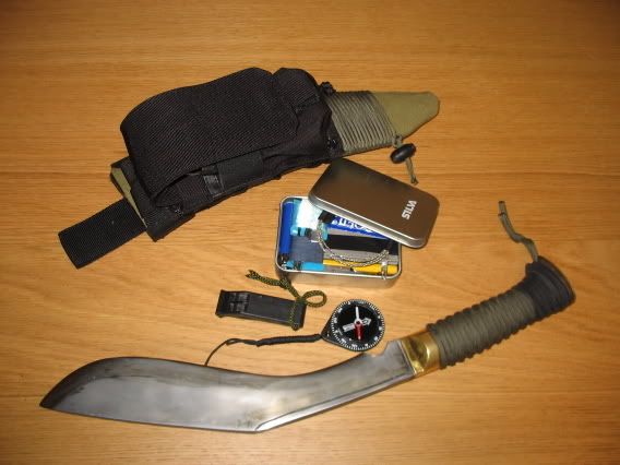

The last step was the addition of a front cordura pocket to store some small items. The pocket is actually a Blackhawk S.T.R.I.K.E. MOLLE single-mag pouch - the size is conveniently adjustable. I added some extra lashing holes to make the pouch fit snugly to the sheath. Finally, I wrapped the sheath with a length of paracord.

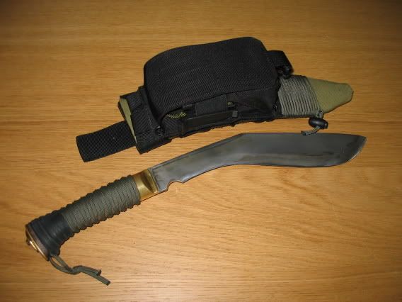

Here is the finished knife together with some “survival” items that fit in the pouch. I wrapped the handle with more paracord to increase the grip, and a piece of bicycle inner-tube prevents the paracord from unravelling while it adds some extra grip. This is the first ”gadgeted” setup that I have tried, and I am not sure if I will like all the extra stuff on the sheath in the long run, but making all of this was a lot of fun. The WWII in this setup is by far my best chopper; I have brought up the edge to shaving sharpness, but it needs some more thinning to reach its full potential IMO. Hopefully, I will have some time to try it out this weekend.
