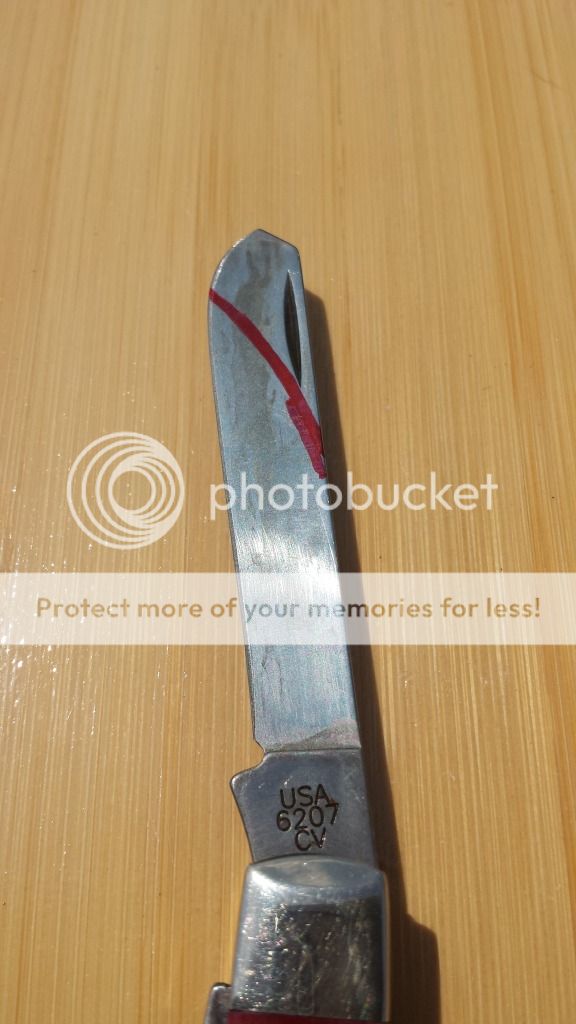

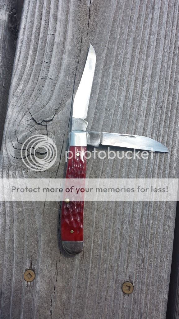

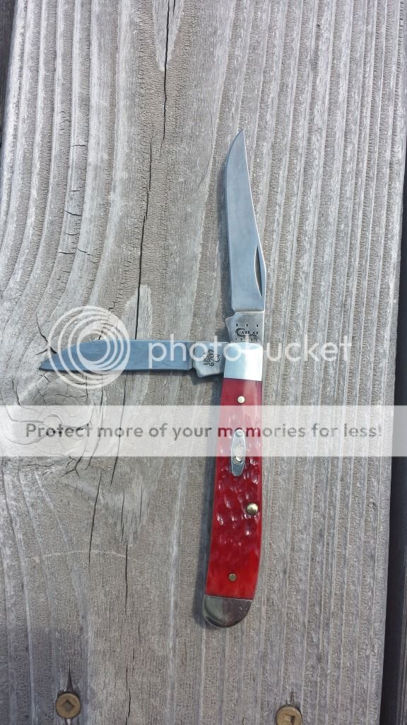

Well, it's ugly but I did it. I still plan to clean it up some more and maybe work on the blade profile a bit more. I'm not happy with my nail nick...I didn't have it clamped tight enough and it moved while I was trying to cut the nail nick. Oh well, lesson learned. I may be able to clean it up a tad as well.
I'll definitely be trying more mods in the future and I'll post up more pics of this Mini Trapper after I get it where I want it.
Anyone want to trade me for a Case/Bose? :D :p

Thanks for the comments! It's pretty rough but not terrible for my first time ever trying anything like this, I guess. Didn't have a clue, just kinda went for it. It was fun and I learned a lot from doing it. When I get some time and finish it up, I'll post some more pics.
