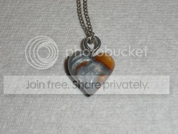

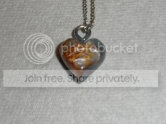

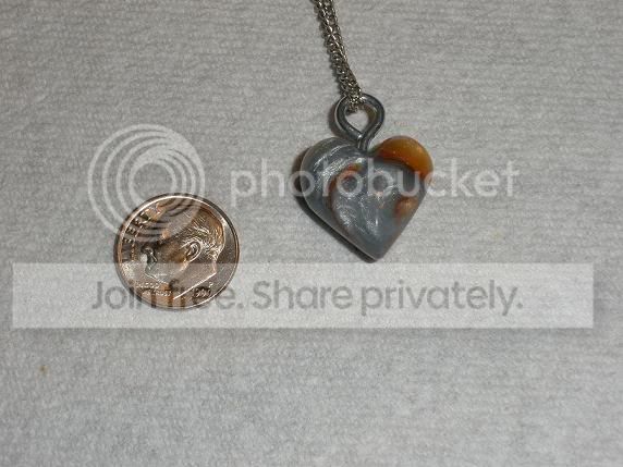

So I ordered some acrylic blocs that I wanted to check out how they looked finished. I bought a couple blocks that I liked and there was one I wasn't sure about and I got a small scrap test piece to see how it looked finished. I kind of liked the scrap piece but I just cut a thin slice and made it shine. Then I got the idea that that it seemed kind of a waste to just have a nice shiny piece of acrylic that is essentially useless.
So I then decided to take one of the blocks I bought and see how that looked finished. But again I said to myself "why just have a finished square piece of useless acrylic?" So I figured I'd try and make something out of it... Here is what I came up with.
What I need to do is come up with an easy way to hold it in place when I'm sanding and filing it. Holding it in my fingers the whole time it a bit of a challenge. I can't tell you guys how many times that thing slipped out of my hand and bounced behind every possible nook it can find under my workbench :eek:
To polish stones they use what is called a dopping stick. A wood or metal rod glued to the back with adhesive wax or epoxy.
A dop stick will work for hard materials ,or where the back isn't going to be seen. For soft materials like this acrylic, I often pre-shape the piece, and then drill the bail hole. I glue in a steel pin (CA glue) and then hold the pin in a pin vise. This allows the whole thing to be handled like a lolly-pop. When all the shaping and polishing is done, just heat the pin and remove it. Add the bail or loop and you are done.
