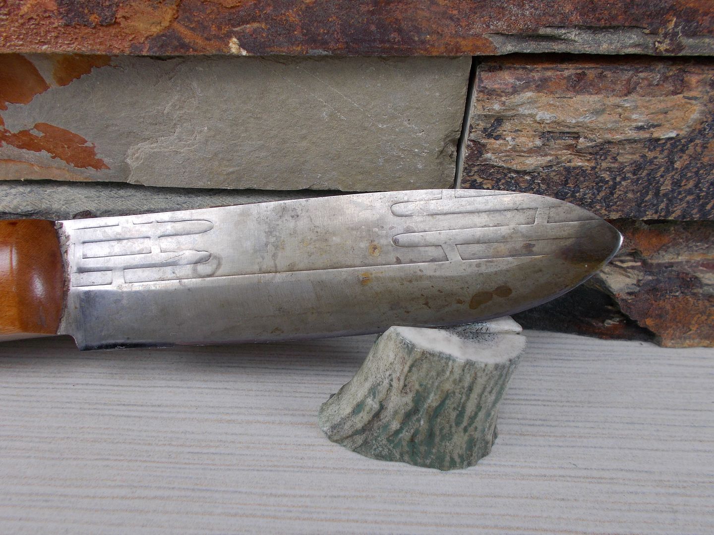

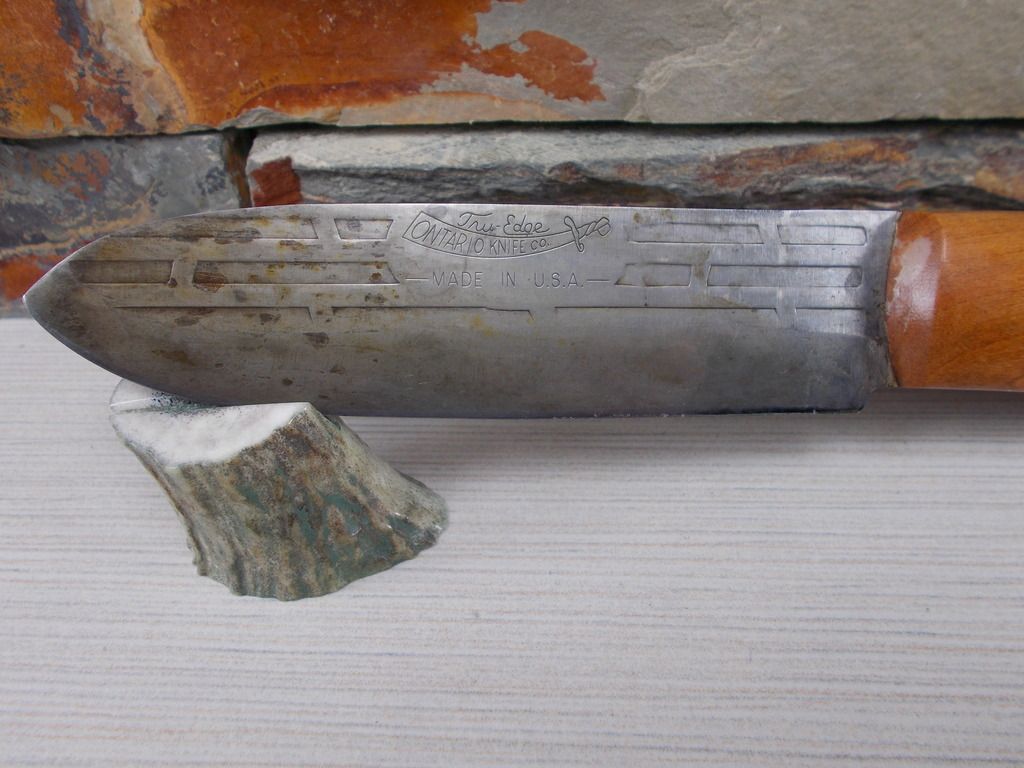

Here is the beginning of my project…I bought a 7" Old Hickory butcher knife.
I wanted a more blunt end than most Kepharts being made these days.
I did a little grinding making sure to use lots of water to keep it cool.
It ended up being about 9" overall.
I love the look of the Old Hickory blade with the Ontario Knife Co. logo and "Made in USA" stamped on the blade!! :thumbup::thumbup::thumbup:

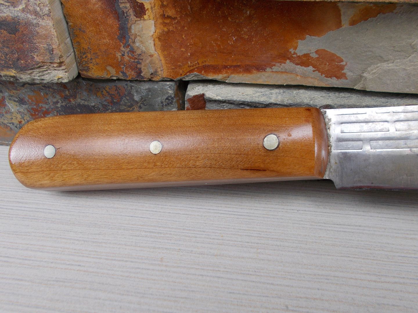

Next I sanded the pins down a little, then peened them to fill up the lightly angled holes in the cherry handles.
I love the thickness of the blade steel on this knife!!

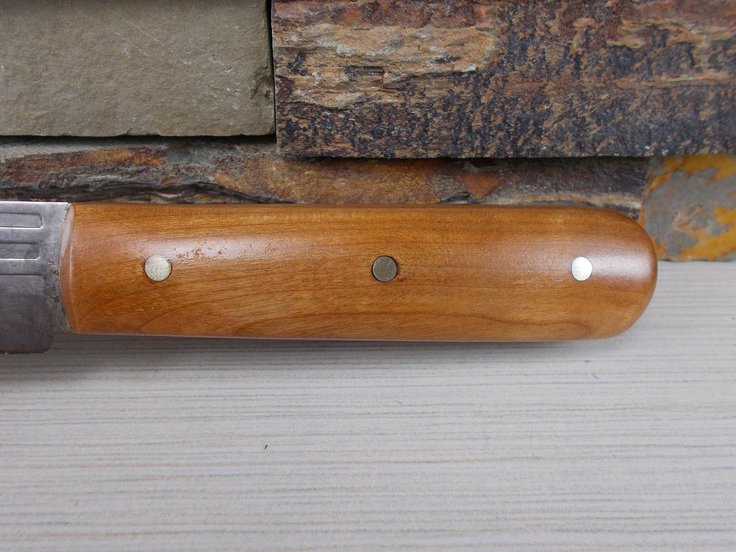

I kept sanding until it felt just the way I wanted. It fits my hand very well!!
Top view of the handle thickness.
I put six coats of Danish Oil on the cherry handles and sharpened, then stropped the blade.
I have never felt a more comfortable knife than this.

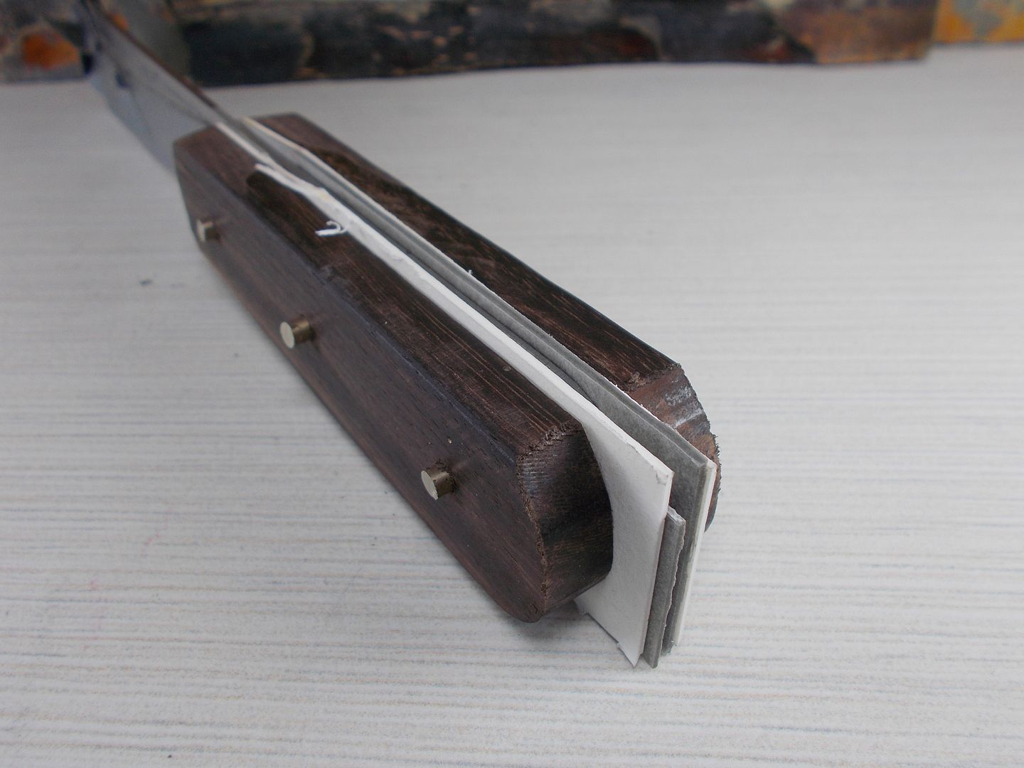

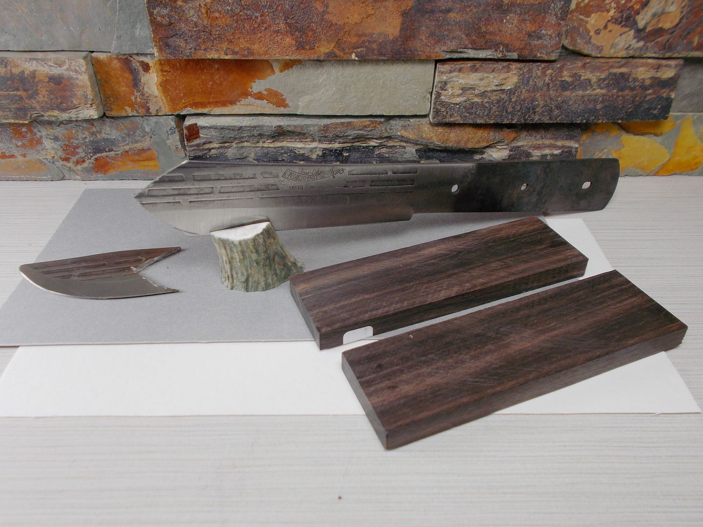

I liked the first one I did so well that I decided to do another, but slightly different than a Kephart.
I left the blade deeper and about 1/2" longer. It got a grey liner next to the blade, then a white liner, then pinned Macassar ebony.
The one with cherry covers has become my most used knife of all the varieties I own.
Hoping the Macassar ebony one gets as much use.
