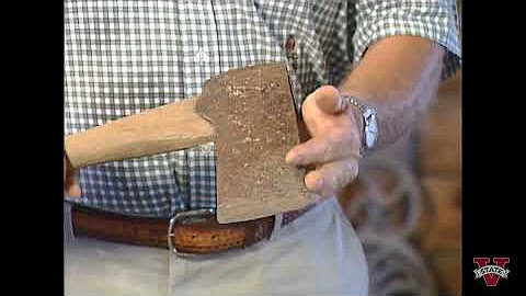

It would really be something to see those trees. I have been reading up on the industry and found these articles. The first one shows those chevron marks. There were special axes used for turpentine work, and I occasionally see them on auction sites.
The guy in the article has a FB page which is public.
