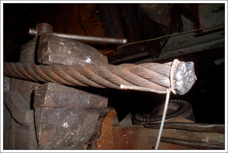

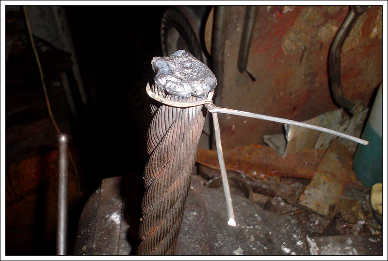

Welding one end of the cable.
I tighten it with wire so it stays as compact as posible.

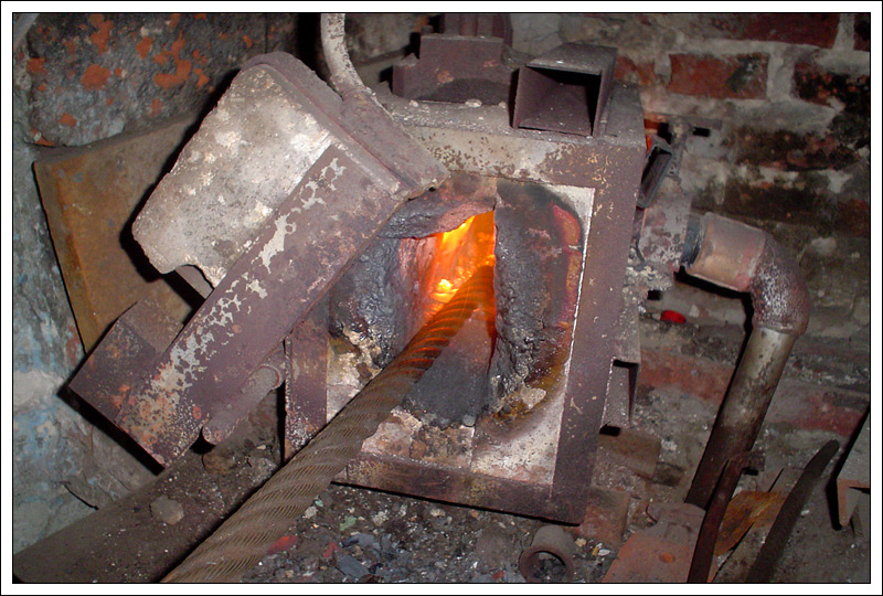

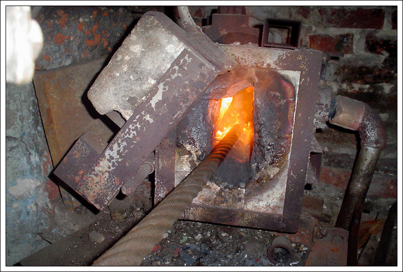

Then I place about 10" of the cable inside the over, til it reaches 800C, in order to burn residues.

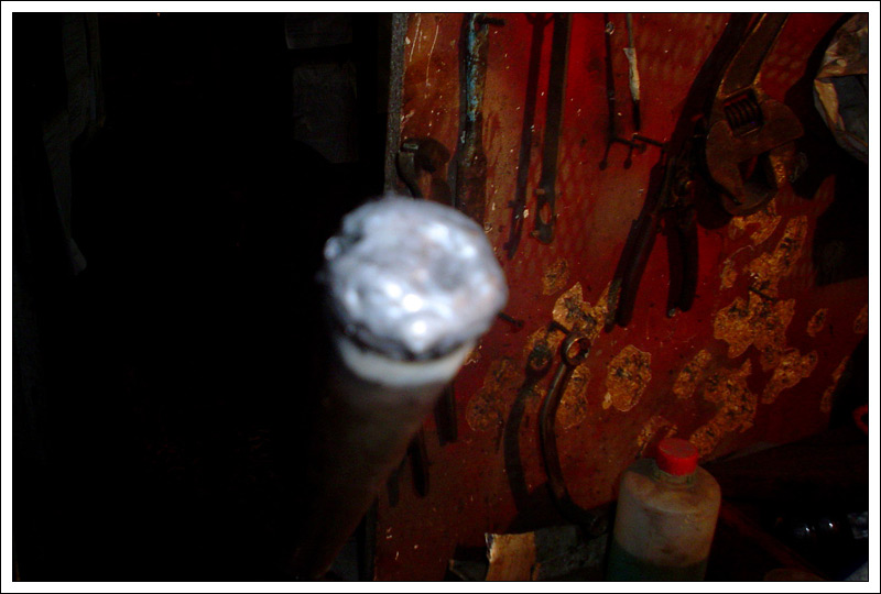

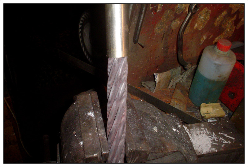

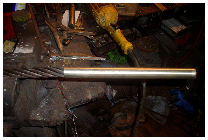

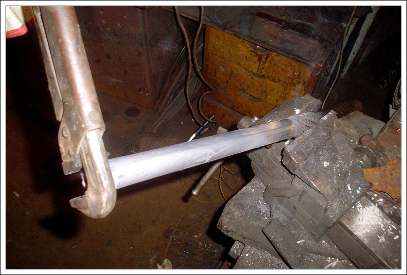

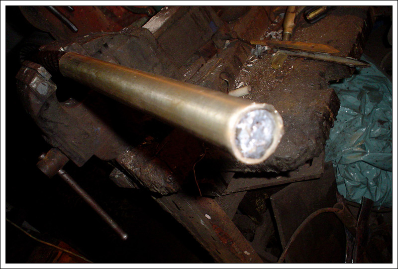

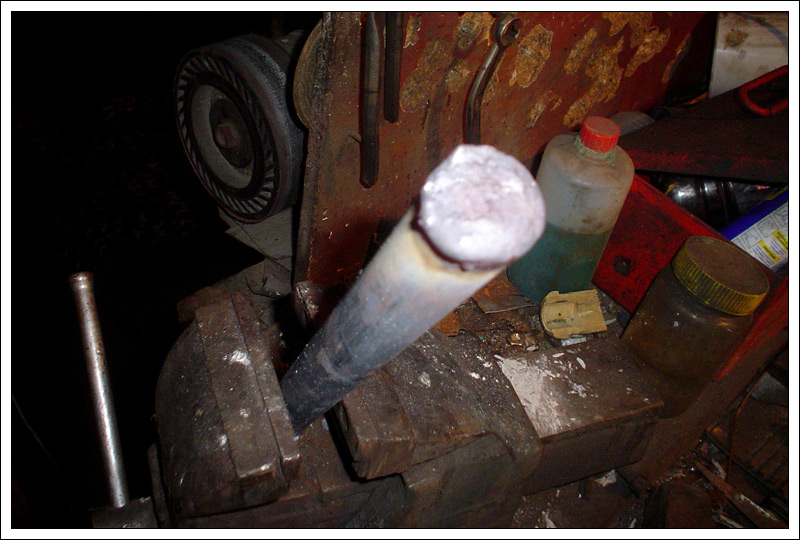

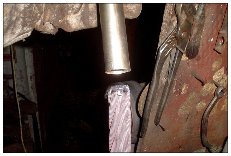

Then I place the cable inside a stainless pipe.
Then I weld the cable and the pipe together.
Then I place this inside the oven, again, til it reaches 800C.

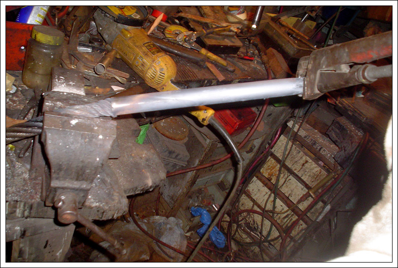

Then, while the cable is elastic, I twist it, to make it very tight.

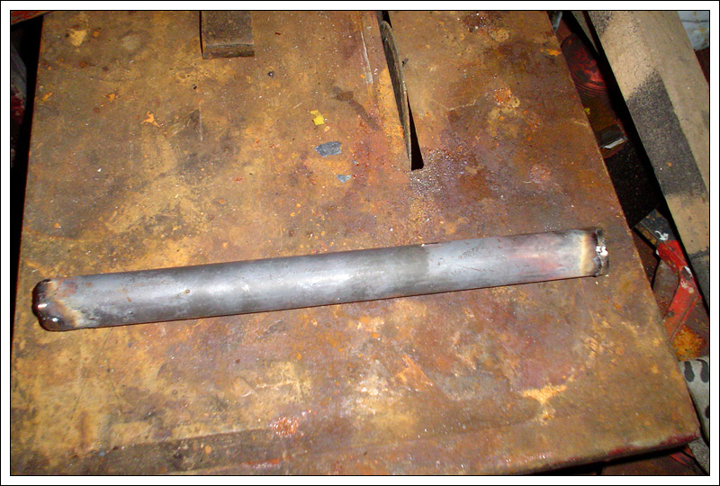

Then I cut the package and weld the other end.

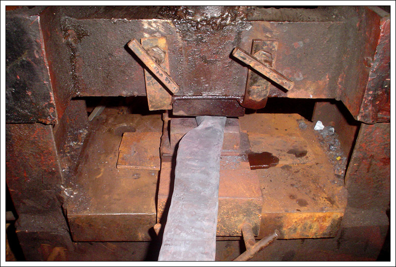

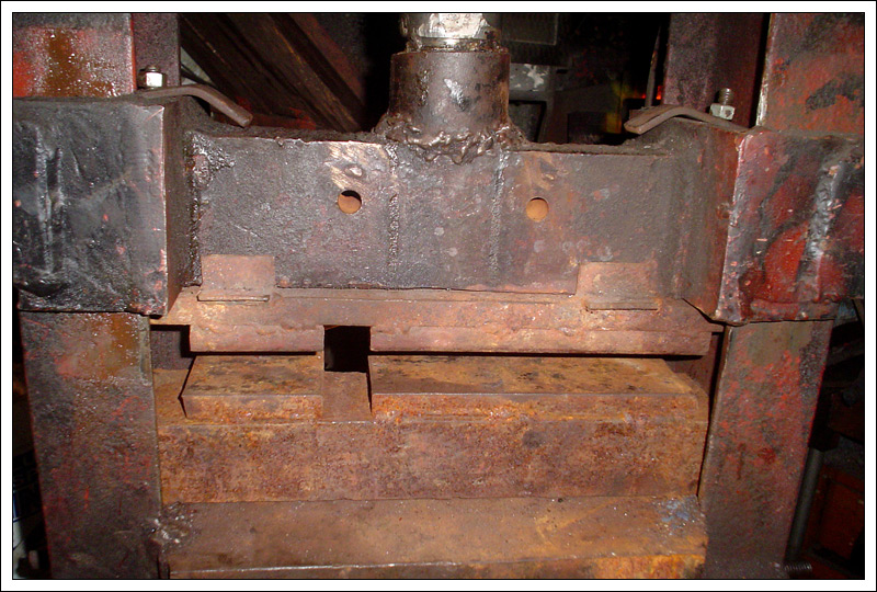

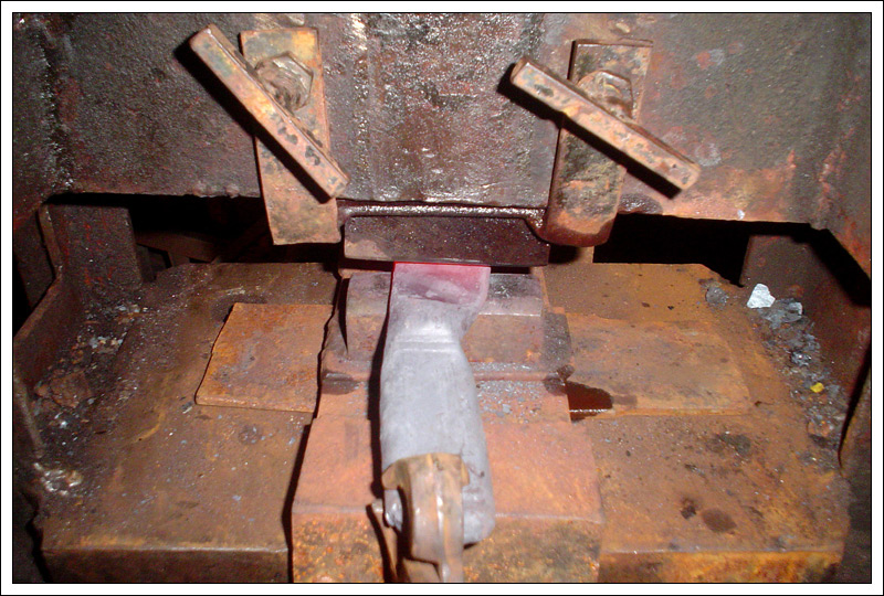

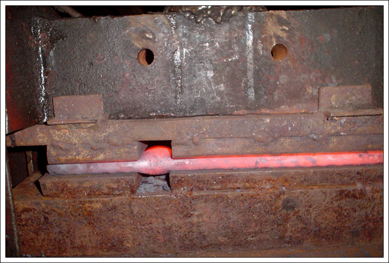

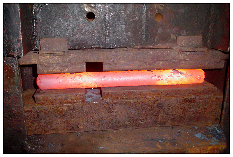

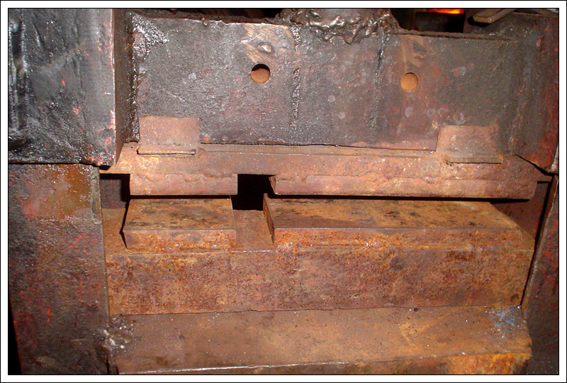

These are the dies I've made to be able to press the blade and tang, while leaving the bolster untouched.

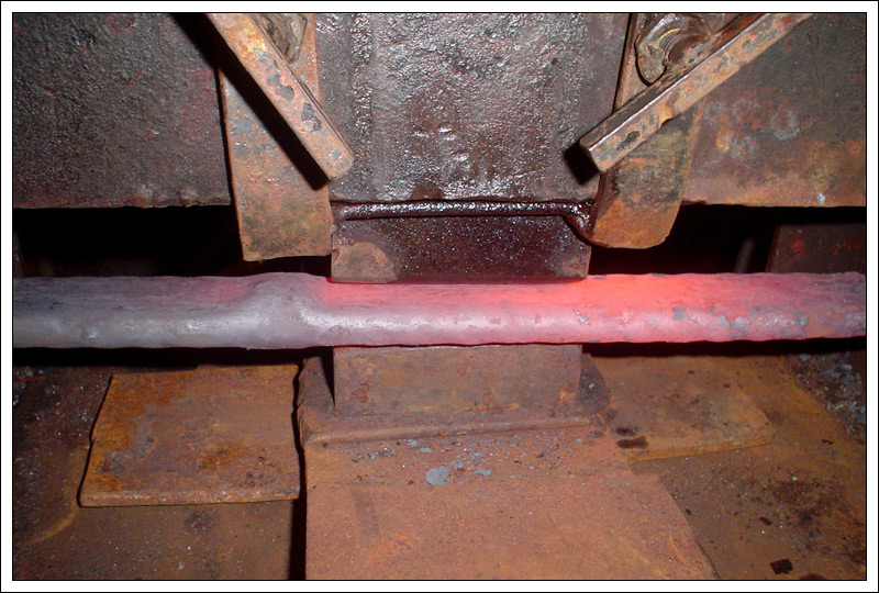

Here's the package at 1300C, positioned in place and ready to be pressed.
And here it is being pressed.

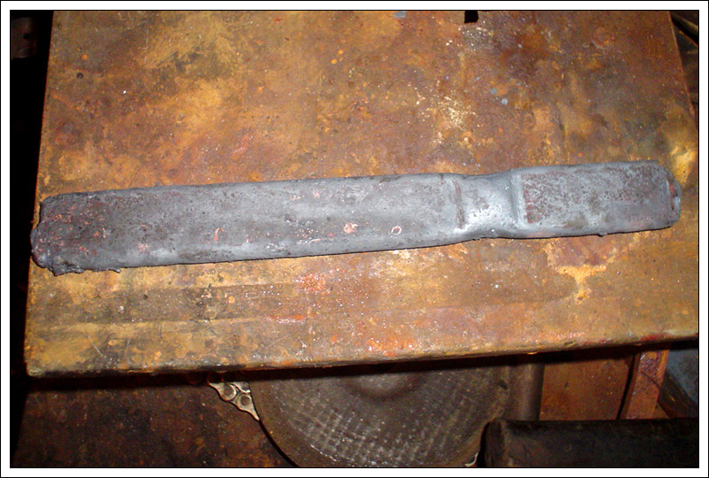

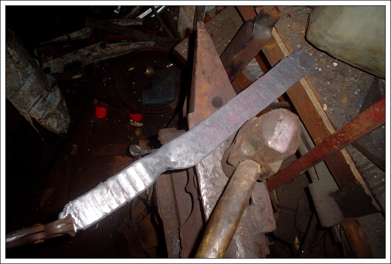

First pressing is done and the package looks like this.

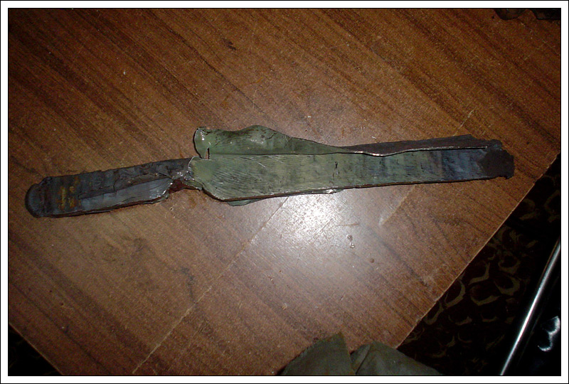

Forging to shape.

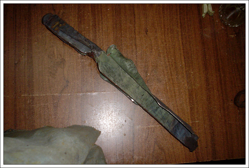

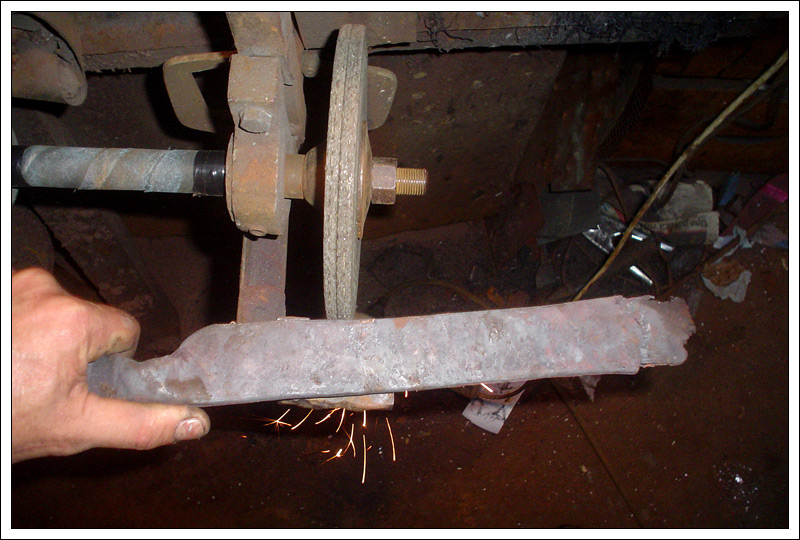

Now it's time to get rid of the stainless enclosure.

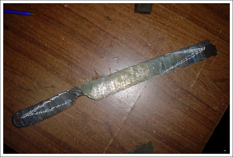

Chalk drawing of the desired blade so I can cut the metal to shape.
Rough blade.

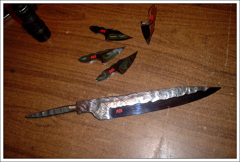

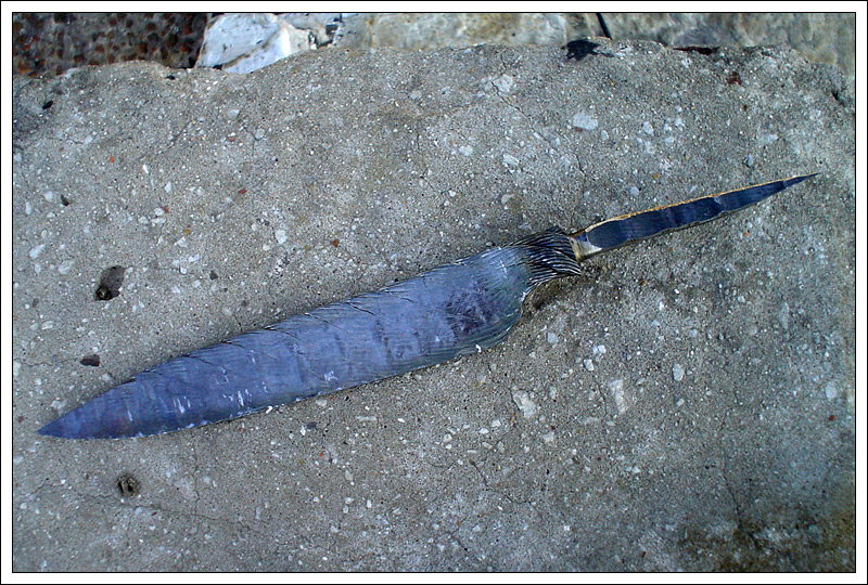

And finally, the ground blade (and 4 cable neckers), ready to be placed on acid.

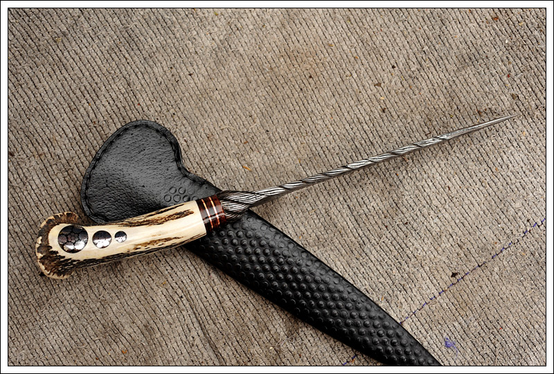

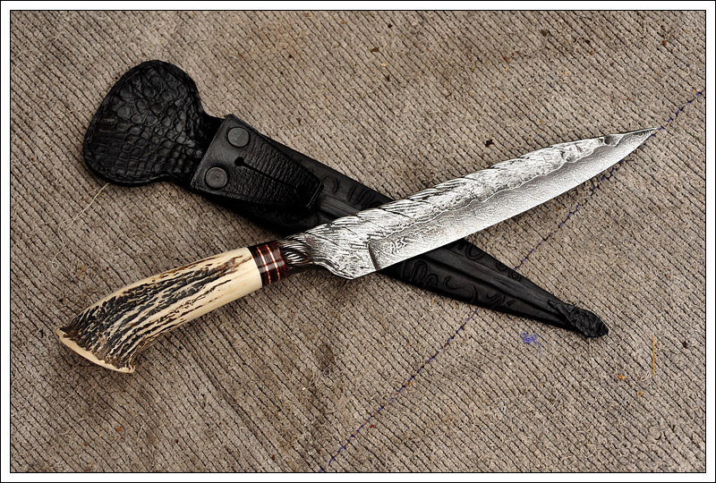

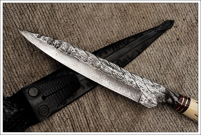

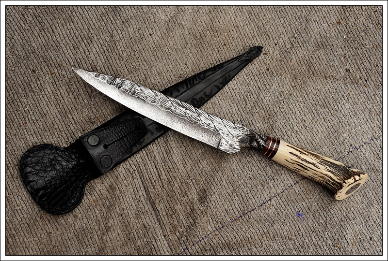

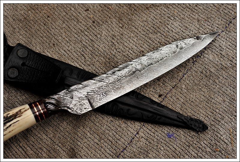

The resulting knife!
And the neckers (heat colored)

Ariel, very cool to see some more of your work. That knife turned out really nice! The inlays on the handle are very cool.
One question, Is there ever any concern with a cable knife like this that it will de-laminate at some point? I assume the reason you press it inside the stainless pipe is to keep the cable in one piece during the pressing process. By the time your done is the cable completely fused or is it possible for a knife like this to separate if not done correctly. I'm just curious, this method of forging is pretty fascinating!

Cable won't delaminate, it's SOLID :)

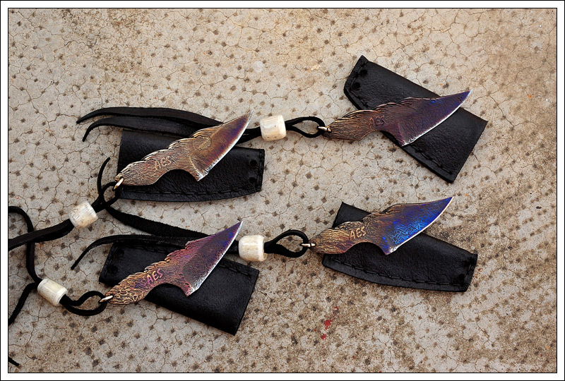

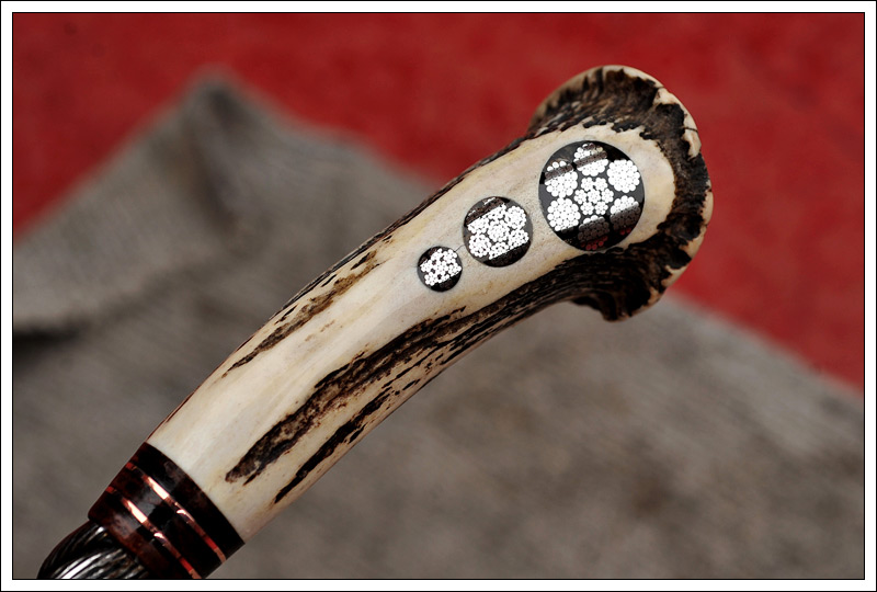

Pins are cable too, here's a picture!
