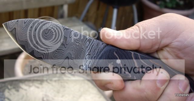

I just received my Nessmuk from Ariel and COULD NOT BE HAPPIER.
I was doing a search on the damascus steel used in it and found this thread.
Here's my finished piece by ARIEL
Tom
