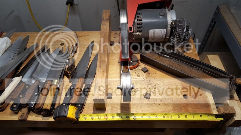

See if these photos help you any. You can see that my bench is about 37.75" high, and there is 25.5" clearance between the bench and the shelf above the grinder.
Perfect Jesse! Didn't think about the light shelf above but thanks for including that.
Looks like the screw footprint is about 9x15 so I'm cooking with gas. Just need power, move around my lighting and set up a bucket.
Here is the current...Belts hang on the wall to the left.
