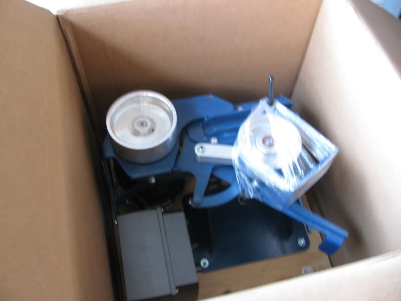

Well here is some pics. This is how it arrived.

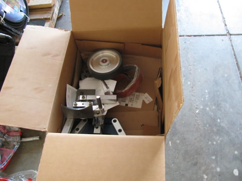

The drive accessories came in there own box.
The grinder showed up the next day so I had to go pick it up at FedEx since they couldn't seem to deliver it after I got off work. It was bolted to a piece of plywood on 2x4 in the box. Good thing. It didn't feel to heavy so I tried to pick it up. Big mistake, as I lifted it off the tailgate the box was just to bulky to hold despite the weight. and dropped on the ground from the height of my tailgate. Ouch. You will notice there is plenty of room in the box and if you are moving one at home go ahead and cut some handholds in the box. There is plenty of room but still be careful about it.

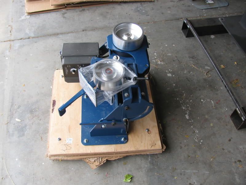

after cutting away the box to move and get to it.

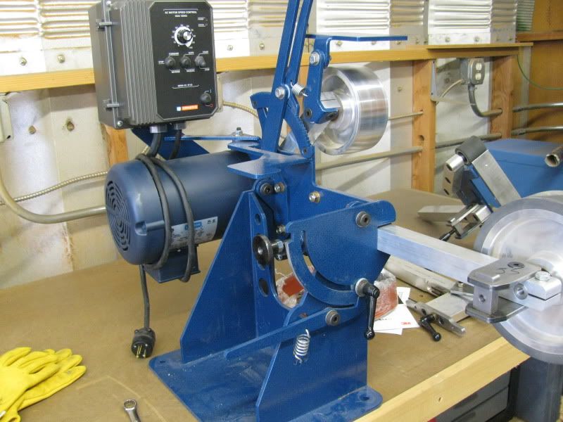

I didn't have the right size bolts to bolt it to my workbench so I just set it up.
I did attach a c-clamp to the base and turned it on to see if would have any problems right out of the box like my other grinder did. It ran like a champ right out of the box even after I dropped it. It's also a good thing that I didn't have the right size bolts as the grinder sits higher than my other grinder and is to tall. No problem as I took delivery of two new workbenches that are shorter yesterday evening and will be setting them up over the weekend.

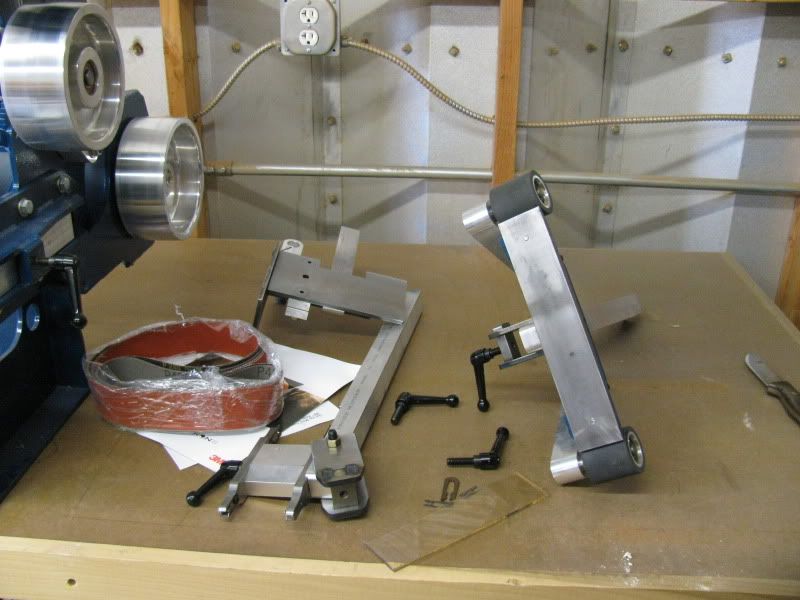

Here are the drive accessories that came with it.

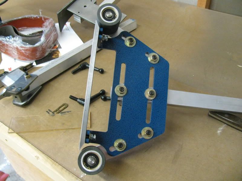

You will notice that the idler arms on the flat platen can be adjusted. So if I add ceramic glass to the platen I don't have to mill the stock holding the platen to adjust for the increase in size.
Here is the platen that can be so universal it probably needs its own thread on all the things you can do with it.
