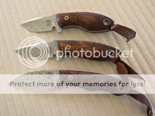

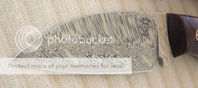

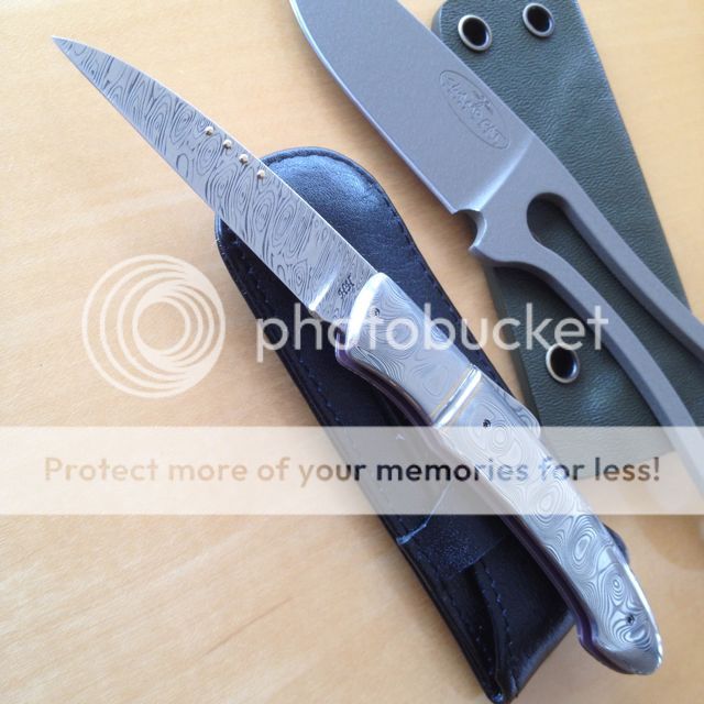

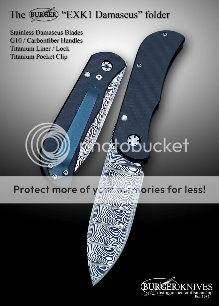

Check out post 12 on >>this thread<<. Des Horn is the South African agent for Damasteel and many of our local makers use it a lot. It is excellent clean steel and correctly heat treated, just brilliant. Remember that one half of Dama is RWL-34.
Just a quick comment on the twist&#8230;&#8230;.ERA used to make a nice tight twist which was really stunning on smaller knives and folders. They have changed the twist pattern somewhat going to a looser twist. Still nice but not as attractive.
Feel free to PM me if I can help in any way.:)
Some of mine&#8230;&#8230;&#8230;.
