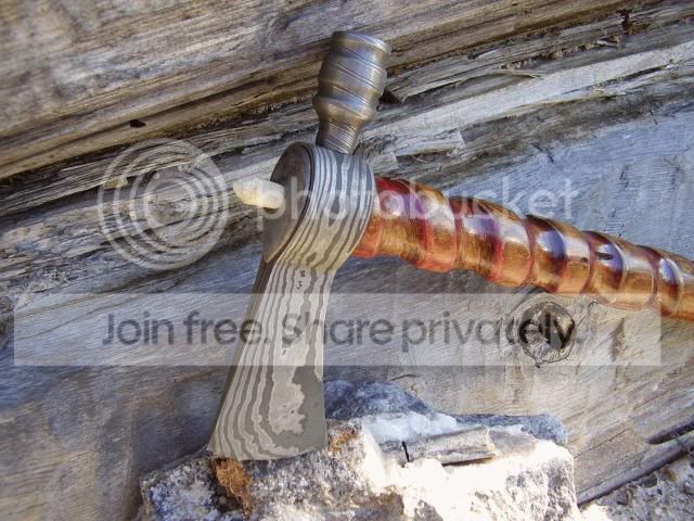

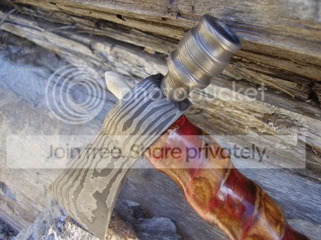

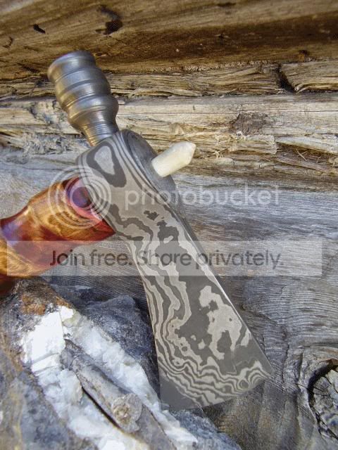

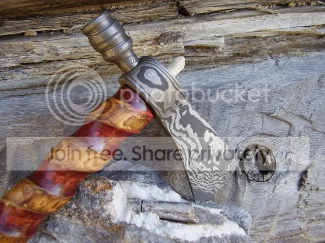

I just finished this one this morning i'm not sure of the alloys in the head it's a bar i have had for a while and was not marked the bowl is from a round twist damascus bar of 1095/15N20, the haft is lilac with walnut stain. Mouthpiece and plug are antler.
O.a.l. is 17" from tip to tip. The head is 5 3/8" with a 1 3/4" edge. Thanks for looking!

Was the wood already twisted like that or did you grind that in.I have a twisted dogwood shoot that has been drying for a couple years just waiting to do a handle like this out of.
Bruce
Thanks guys now i can concentrate on my next one which will have the special haft from Stacy.
Nice one Bob. Looks like you have been busy. How did you fasten your bowl to the head? Good job. Paul
Paul i drill the hole in the haft so the threaded piece from the bowl threads right into the haft. And the antler plug is threaded as well. Thanks!
