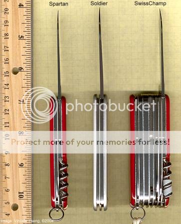

Is your SAK blade twisted? :eek:
Don't be too hasty in answering "no" -
Look at the typical SAKs closed -
Notice how the main blades have to be at an angle to fit in with the opposite tool?
Now this would account for perhaps the blades not being quite straight in-line with the body.....
BUT now look carefully please at the blade's grind from the edge side (use one eye) - especially on the Soldier -
Notice how the blade's grind is not symmetrical? In fact looking closely it's almost as if it was twisted - like someone had grabbed the blade face and twisted the blade.
This is still there, just not quite as pronounced, on the regular standard SAKs.
Again once we realize that the asymmetrical grinds are there so that the main blade can fit nicely with the other tools - it then makes sense.
But viewing the blade in isolation - it is TWISTED! :eek:

Vincent, you must have been reading my mind. I picked up a Soldier a few days ago, and I noticed the same thing when I was messing around with it. I thought it was defective at first, until I realized that was the only way it would work. It doesn't seem to affect cutting ability at all though.

The "twist" is known as "crink" and is common in multiblade knives, you can easily see it in a typical 3 blade, 2 spring stockman and many other traditional folders.
The Buck slipjoints avoid the crink but instead each blade has its own backspring. So for the number of blades it makes for a thicker knife.
I've always been aware of the assymetrical grinds on SAKs and other slipjoints but never was bothered. In fact, on SAK's the screwdriver is often ground unevenly so it doesn't need crinking.

Taking a picture of a series of knives like that is NOT an accurate way to judge if the blades are twisted. You would have to photograph each one straight on in the center of the lens's field of view. Each knife to the right and left of center will appear more and more twisted as they get further away from center.
I'm not saying they aren't twisted, just that taking a photograph like that isn't a good way to judge.

Agreed that using a camera lens especially a wider angle lens to photograph will have some geometrical distortion and perspective distortion - so that objects toward the outer edges may be rendered more distorted than real life.
However the "twist" here is that these photos were taken with a flatbed scanner!
I'm not saying a flatbed scanner is totally free of distortion - there is some "perspective distortion" that I have noticed as the scanning elements do not strictly look straight up through the flatbed plate glass - and like a camera lens it is outer edges that are most affected - but it is minimal compared to camera lenses and there is no geometrical distortion to speak of.
Because I am aware of the outer edge perspective problem I lined the knives in question up along the middle of the flatbed plate glass to minimize this effect and made sure the most twisted blade of the Victorinox Soldier was centered in the scan area........
I hope that mitigated some of the problems - plus I did ask people to actually look at their blades to see the twist for themselves - so the photos were really just illustrations - and NOT meant to be absolute/accurate measurements - I think they fulfilled that capacity?
