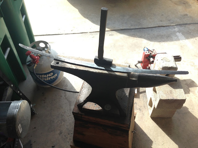

My primary forge for over a year has been a vertical 2 brick set up. The bricks were about 5x4x10 hollowed out and stuck together; the inner cavity is about 6x4x7 and coated with ITC-100. I then wrapped the whole thing in 1/2" of refractory blanket and slapped on satanite to keep the fibers from getting airborn. It has hole on both sides to pass blades through.
With a 1/2" burner from hybrid burners I get it to over 2000F. A bernzomatic adjustable torch connected to my propane tank can hold from 1100 to 1600 for heat treating/normailzing smaller stuff.
Having it vertical prevents the hot spot you get from the horizontal config, but of course it's harder to heat treat longer blades with it (anything up to 6" is fine tho).
You can see it in the right hand side of this image beyond the blade and the anvil. This blade was forged with the vertical 2 brick forge.
