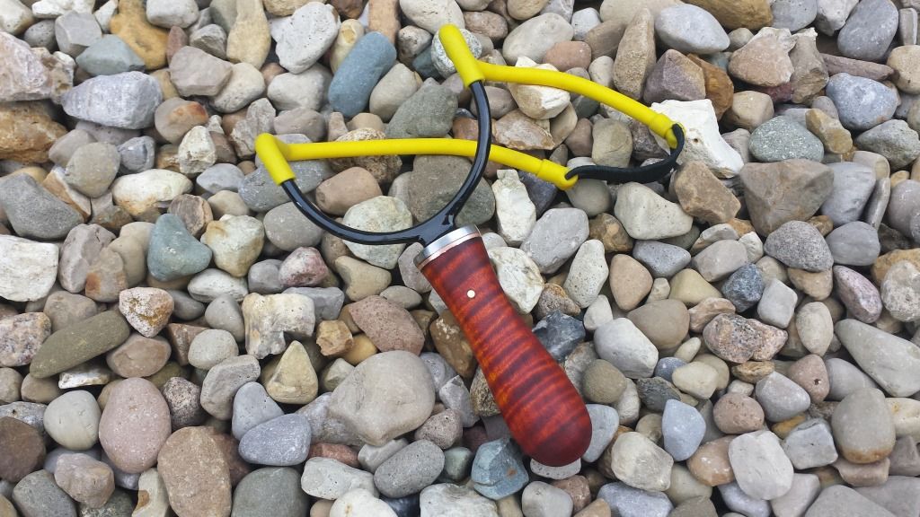

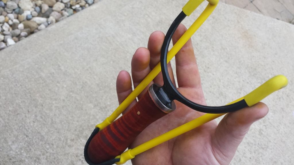

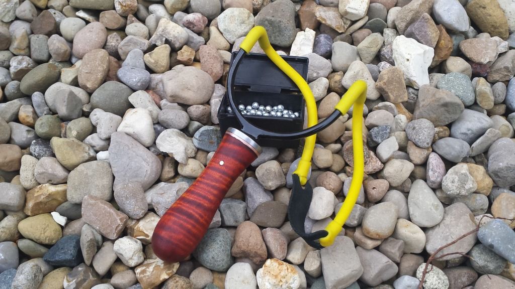

So, figured I'd run this idea by you Beckerheads before I let the rest of the world in on it. This is a little back burner project I have been wanting to try for the last 6 months or so. Finally got a chance to play around with it.
My boy and I have enjoyed getting into shooting slingshots in the back yard. I have gotten pretty good at it and can usually hit a 6in. Target at 20 paces 9 out of 10 times or so. I've only used the cheap 5 buck daisy slingshots and told myself if I got halfway decent at it I would buy a good one. Well, cant find a good one to my liking, so, in true Todd Hunt form. I made my own.
My first attempt failed miserably and taught me that the limbs need to be pretty precise and there length greatly effects how much pressure is on your wrist.
This one shoots really well and uses the 3 dollar replacement bands you can find about anywhere.
I made this one out of scrap material laying around the shop. 1/4in. Cold rolled round stock I formed around a pipe. Welded and smoothed the finger guard making the steel all one piece. Copper spacer and curly maple handle. This one was made totally by hand and took me about 5 hours. I think if I make jigs and fixtures I can cut that time in half and make a few at a time.
I think I will play with the design a bit. Thinking I may shorten the limbs another half inch. Might try some finger grooves in the wood or try some G10. Also thinking handmade belt pouches that holds the SS and the ammo. What do you guys think? Might make a batch and see if it sparks any interest.

Todd! That slingshot looks sweet man!

That's very cool! I suspect the the combo you're talking about has merit!
