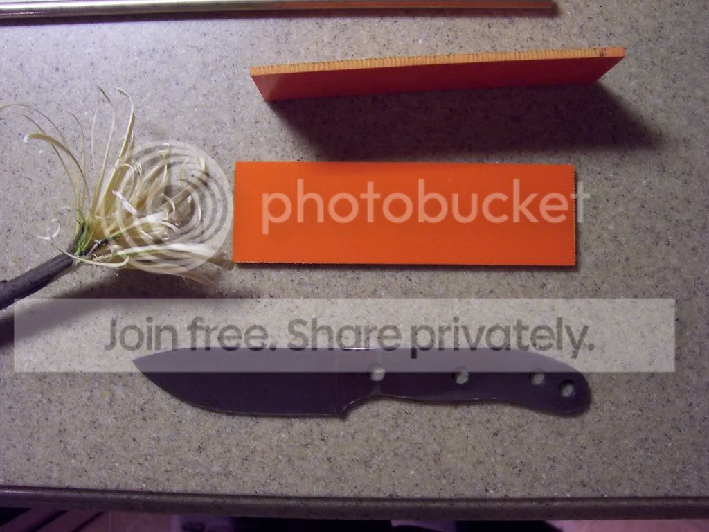

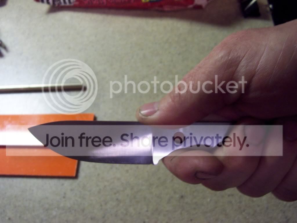

I have been wanting to make up a (pskk) Personal survival kit knife this is
one that I have done so far I am going to put in silver nickle tubing and white
liners with orange G-10 1/8th scales. I got far enough to day to get it sharpened and made up a fuzz stick. It shaves the hair off my arm and cuts
paper like crazy. I also took a pic of it in my hand. The blade is just under
3" the over all lenght is 6 and 3/4 inchs long and is seven sixty fourths of and inch thick. Heres is a few pics

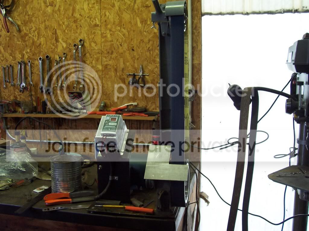

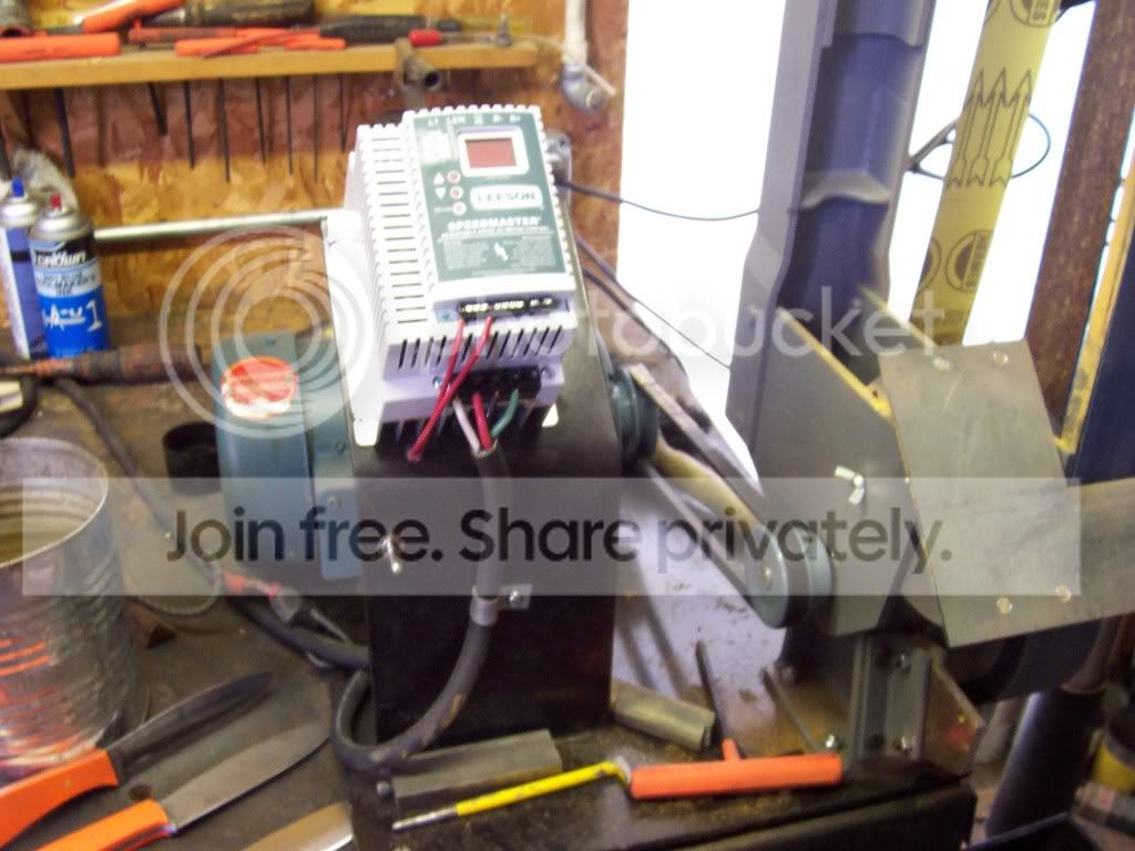

This is part of my set up for making knives it is a Coote grinder with a
2hp varible speed motor.

A bit off topic: Those variable frequency drives for the motors are nice. I have one on a mill, and I'm itching to put one on my belt grinder. It's not really in line with the grinder, but I've read it's pretty easy to short one and burn it up completely with the metal dust floating around in the shop. The dust goes through the vent slots and builds up on the circuit board. It seems to be a semi-regular occurence on the practical machinist forum. Just an FYI.

What kinda steel we talking here?

Hey all thanks for the kind comments. I for got to say what steel Iam using
it is 0-1 i do have some 5160 and will be making some pathfinders and some
pskk s with that steel to. Yes I plan to make and sell knives as a part time
