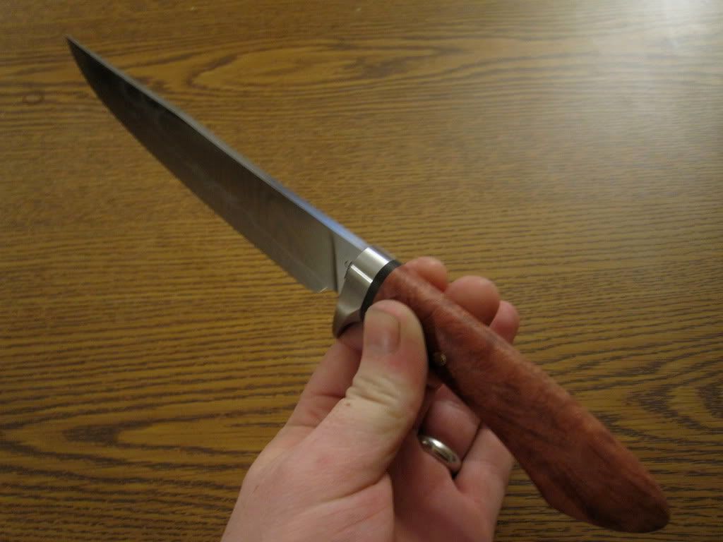

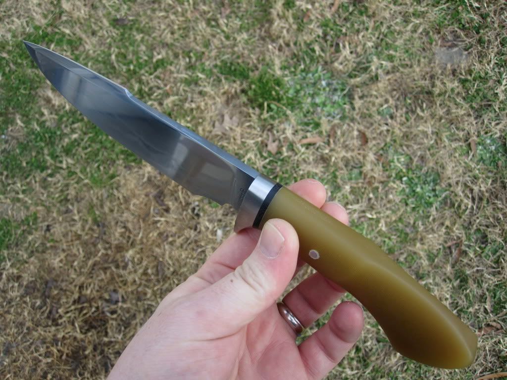

Hey everybody,
I just finished these knives up for blades I finished forging some time ago. i am not finished with them as i need to touch up the blades where they got a few scratched during handle finishing. and i am going to be making sheaths for hem, but i am very interested in your feedback.

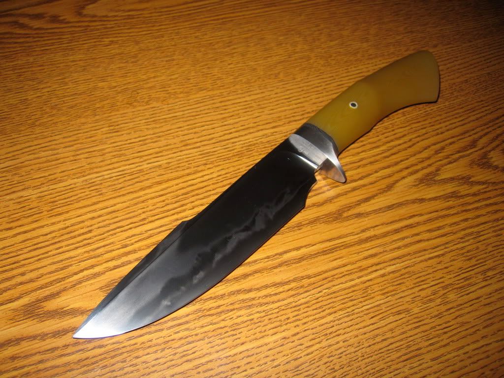

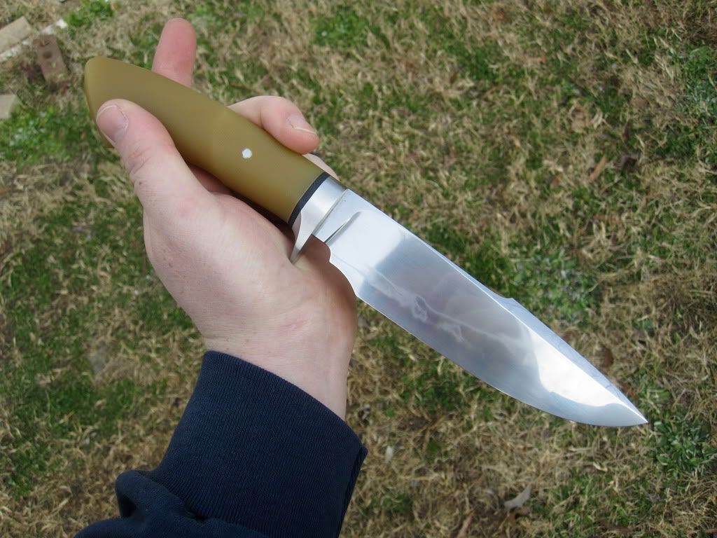

G10 Hunter
OAL 11.5" Blade: 6" long, 0.215" thick
Blade forged from DHIII W2 steel, polished to 2k grit with active hamon
304 Stainless guard Micarta spacer and Stainless pin
Tan G10 handle

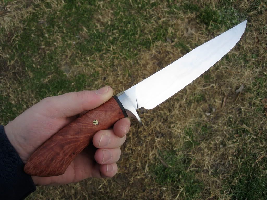

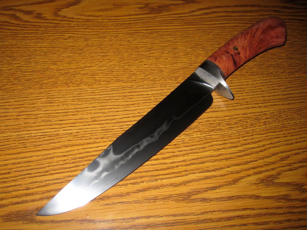

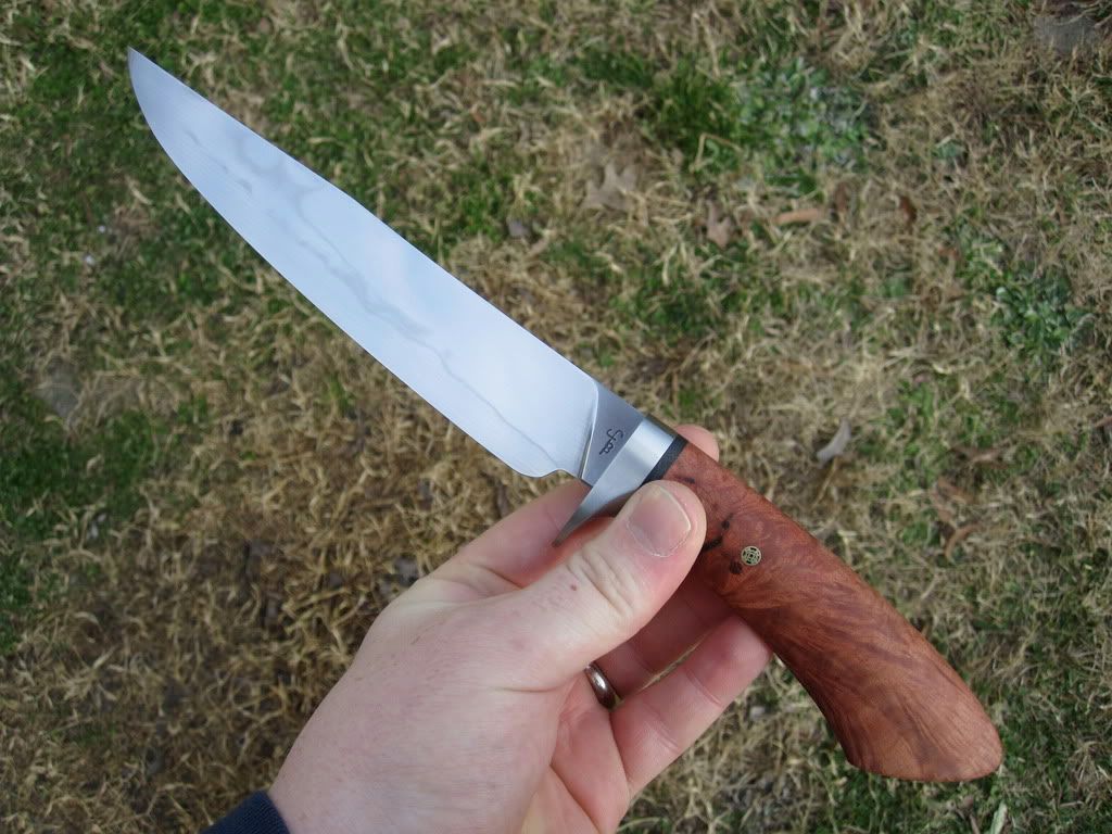

Redwood Burl Hunter
OAL 12" Blade: 7" long, 0.19" thick
304 Stainless guard and Micarta spacer Mosaic pin
Stabilized Redwood burl handle
thanks for looking
~Chris

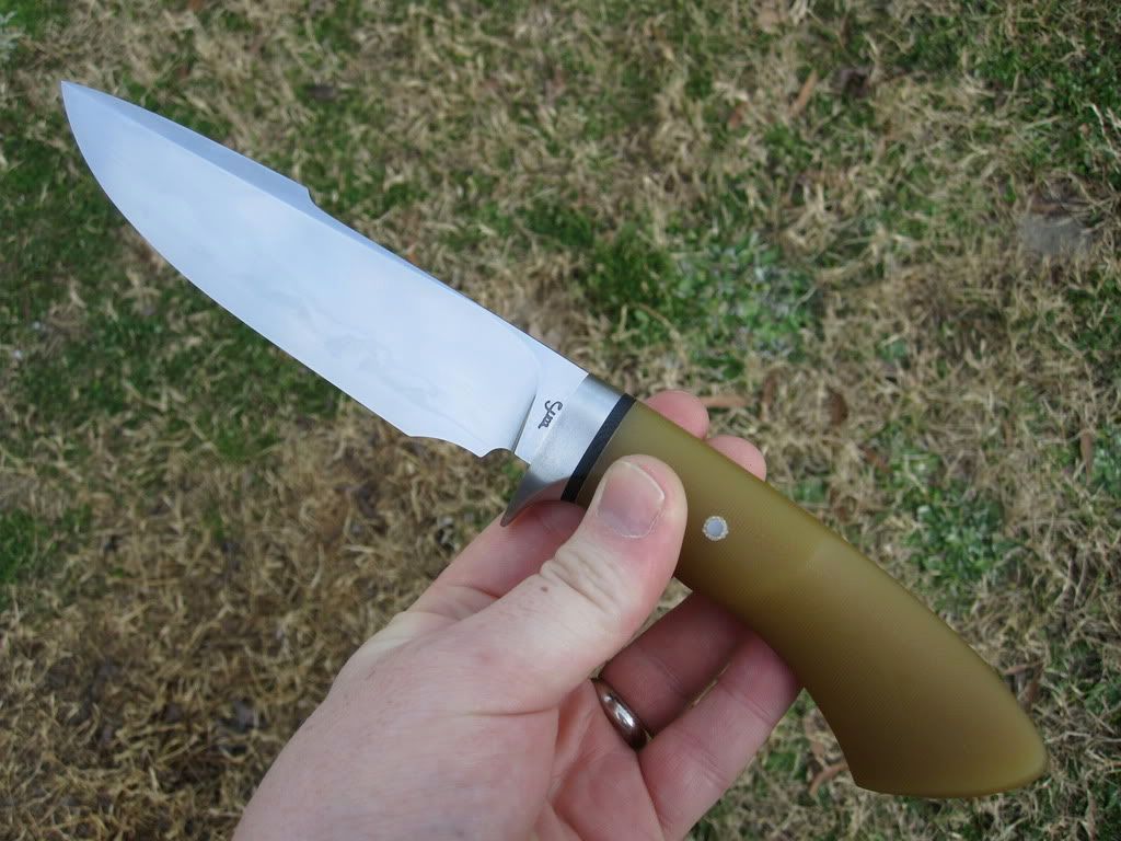

They look great. Did the G10 break out around the pin?
Hey, it is solid around the pin but the color change is from where i peened the pin. I wasn't expecting that as i counter-sunk the holes and everything. This is the first time i have used G10 for a hidden tang knife. i will know for next time not to peen them so aggressively.

That tan G10 looks awesome, almost like some light colored amber. I'm going to try some of that out.
