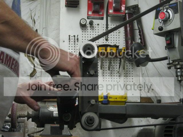

Ready to start building my grinder but not sure whether to go with a 3 wheel, KMG style, or a 2 wheel, ala Coote.
Three wheel seems offer more options however, the two wheel's ability to rotate the belt from horizontal to vertical seems very handy.
Looking for opinions from those with actual experience.
