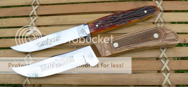

I recently took delivery of the two Queen knives featured here - a Bearhead in amber bone and a Sabre Hunter with Oak scales.
Both are relatively small knives - the Hunter is about 8 and a half inches overall and the Bearhead around 8 inches. The blades are D2 steel and construction is full, exposed tang.

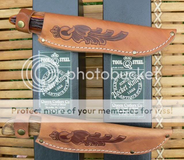

Sheaths are leather and of the same type - basic pouch style with a riveted belt loop and retaining strap with press stud. The retaining strap is not fixed to the sheath and can easily be removed. I tested the retention by inverting both sheaths and giving them a bit of a shake with the press stud closed - the Bearhead was retained but the Hunter slid out of the sheath without much resistance.

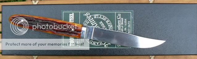

The Bearhead has Queen's amber bone scales that are well known in their traditional folder range - they are functional and good looking. Colour bleeding was apparent and my hands were orange after handling the knife for a while - hopefully this will settle down.

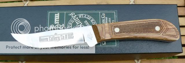

The Hunter has checkered oak scales that appear to be laminated. The grip is comfortable and secure.
I would put the Bearhead in the 'bird and trout' category - it is light, handy and relatively thin with a bit of flex which is ideal for dressing fish and for food preparation. The Hunter is a much more substantial knife - there is a lot more steel in it and it is noticeably heavier.The Hunter could take some hard use - it is a no frills knife meant for work and would make a good all round hunting knife.

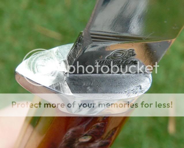

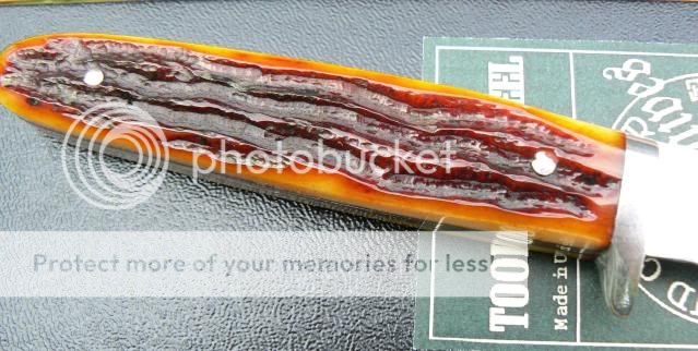

Some news is not so good. The otherwise excellent fit and finish of the Bearhead was marred by an appallingly finished guard. The nickel silver fitting had deep gind marks - I have included a pic but not sure how clear this is.

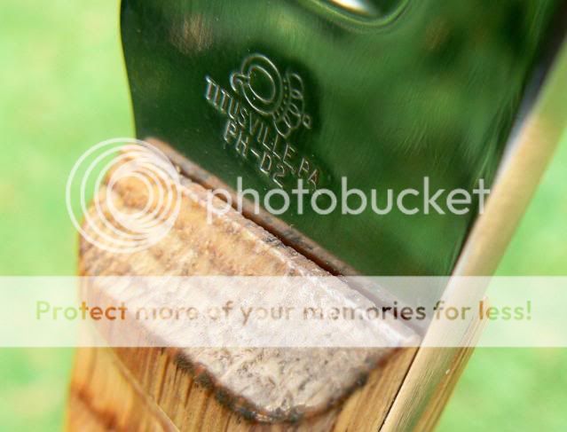

Things were not quite right with the Hunter either - there was a substantial gap between one of the scales and the blade - I will need to get some epoxy in there to seal it up before I use it or it will be an invitation to corrosion with the D2.'

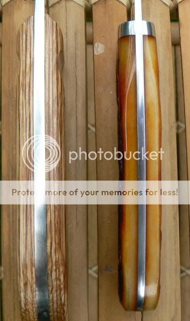

A quick check with a ruler (not real precise) shows the Bearhead around 1/10 inch and the Hunter about 1/8 inch at the blade end of the grip. The Bearhead thins out quicker towards the tip. As you can see from the tang, there is a lot more metal in the Hunter.

Excellent value for money, I particularly like the Barehead, fine fishing companion. The guard is actually aluminum not nickel-silver and it discolours rather fast, metal polish will bring it back. Both knives were sharp, the sheathes are more debatable but at the money one can't complain. Decent knives at a fair price I feel.

I have a few of the Queen fixed blades of both types. True they are not perfect but are very rugged and hold a good edge for a long time. Their old sheaths have even less retention than the new ones. I solved the problem by turning the plastic insert around and putting a few stitches of paracord through the sheath and plastic on the spine side near the top of the sheath and cinched it. This effectively tightened the sheath up so the knife will not fall out when inverted and shaken. With a little TLC they are great bargains as Queen does a great job with their D2. The Premium Hunters are great when convexed.
That's an interesting idea about the sheath insert. The insert itself is an odd thing - most of the ones I have seen on other brands fully enclose the blade but on the Queen sheaths it only seems to give the sheath some support but does not protect the leather from the knife edge or the point. It is more a wrap around piece of plastic than a true sheath insert.

I had one go at sealing up the grip/blade gap on the hunter but had no success. I tried to trickle epoxy through the gap then clamp it but couldn't get enough in there to hold and it came apart when I removed the clamp. I will have another go on the weekend and just try to fill it without clamping.
