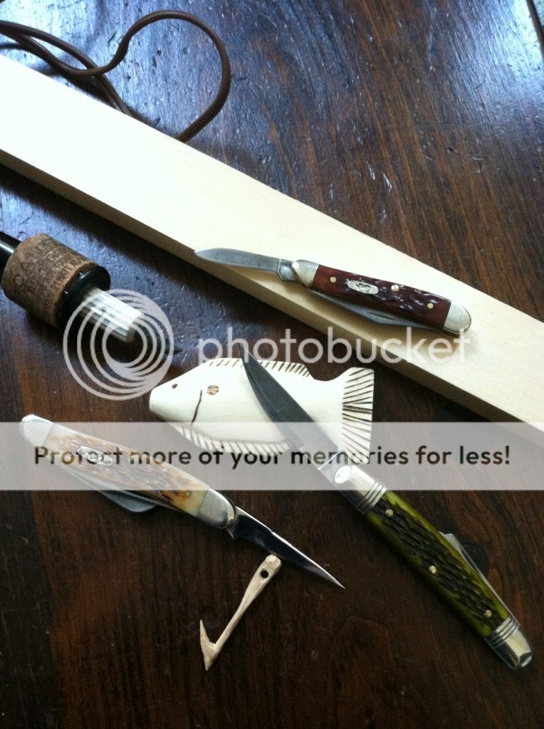

For wood I'll use anything, scraps of pine etc.

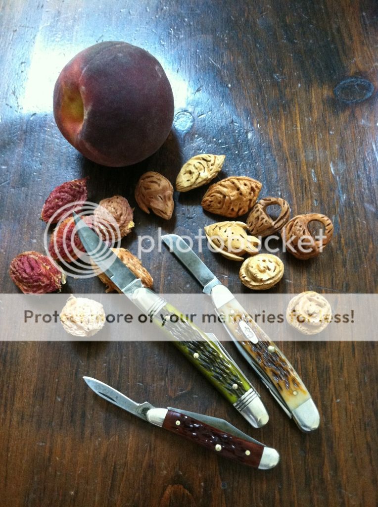

But lately peach pits

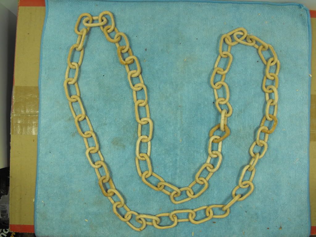

I use a lot of random sticks, but good wood is rare here (heck, any wood is rare here) so I buy basswood carving blocks any time I'm near a Michael's or Hobby Lobby. Pretty tough to do something like this with a random stick.
How long did it take you? I remember seeing a few chains you have done that where open ended, I know you have alot of practice :)
Yablanowitz, don't you have a pic ( if I recall ) of a friends father who owned a lumber yard that carved a continuous chain for years, with hooks on either end? A real work of art.
I remember that picture, but it wasn't me who posted it. Rockgolfer, that took about a month, probably a hundred hours or so.
