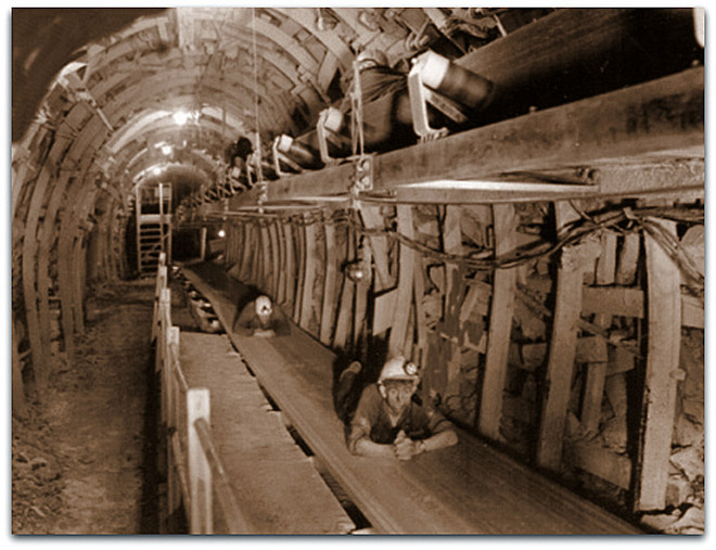

Coal-mines had Belt Crews, whose job was to repair, and extend, the conveyor belts, used to move coal from the coal face (and miners to and from the coal face - see photo below). Each member of the crew was issued with a knife, which I've seen referred to as a Belt Man's Knife or a Pit Belt Knife. Humphrey's Radiant made a shackled Pruner, with a checkered bone handle, for belt manufacturer Hayden Nilos, and these were widely issued to Belt Crews. TEW also made a large shackled Pruner, which is among those issued, (some of these also being marked Hayden Nilos on the blade), and the (British) National Coal Board also bought large orange-handled Pruners from Ibberson's (or Eggington, who use that name), which were part of their existing 'Action Knife' range, embossed on the handle with 'NCB'. Belt crews estimated that it took two men 90 minutes to two hours to splice in a new section of belt. Injuries from the knives also seem to have been fairly common. Eventually, cordless electric belt-cutters were introduced, which reduced splicing time down to 20-25 minutes, for one worker, but Belt Man's Knives continued to be issued and used, though the NCB eventually replaced them with box-cutter style utility knives.

Leave home in the Dark . Work in the Dark . Go home in the Dark . I have been down 2500 feet and out 3500 feet in a mine where there was no light except the one on your head and if you turned it off , you Could Not see your hand in front of your face . TOTAL DARK . Not the job for me .

Me neither Harry! :eek: I have had a lot of friends who were miners though, usually they lived in small South Yorkshire villages, where there wasn't really anything else by way of employment. Then they closed the mines! :oops: I have never been down a coal-mine though, when I was a boy, because mining was such a big thing where I lived, there was always a school trip to one. They wouldn't let the girls go underground though, just the boys, as they said it was bad luck for a woman to go 'down the pit' (must have been a pretty recent superstition!). The year our class was due to go, Britain passed an Equality Act, supposedly outlawing discrimination, and so the trip was cancelled :( I have been down other mines, though they were nowhere near as deep. I remember going down an old lead mine, where we were more or less free to wander around! :D Very young boys would carry ingots of lead, hundreds of feet up crude wooden ladders. I lifted up one of the lumps of lead, but it was very heavy, and would certainly have been so for an underfed 7 year old. My grandfather's brother, Frank, worked down the pit as a teenager. Because he was young, and swift on his feet, they used him to collapse worked-out seams, and he would have to run as the roof came down behind him! :eek:
