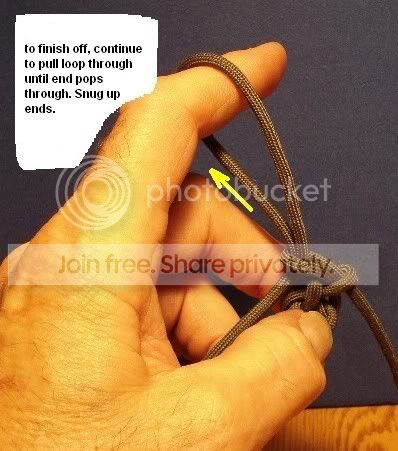

I don't know if this is what you're looking for or (k)not :rolleyes: but it is unstripped 550 and by untying the last loop, the rest comes apart like a daisy chain.
Doc
Thanks DOC. Even a cordage-ly challenged person like me can figure this out. I'm kind of a savant when it comes to stuff like this. :confused:
BB
Hey Doc do you mind posting pics of how you finish the end? I would really appreciate it.
No big secret - on the last loop when pulling the loop out, pull it all the way through, including the end and snug up the ends- that's it!
When you want to unravel it, pull the end (that you pulled all the way through) back through the loop and pull both ends to unravel.
