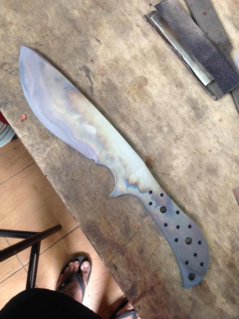

I have used Vanadis 4 E quite a lot in knives.
Here is an article on Vanadis 4 E (unfortunately in Norwegian):
http://kniver.blogspot.com/search/label/Stål - Vanadis 4 Extra
Vanadis 4 E is obtainable in 5,2 mm sheets. I use both that and 10*50 mm bar.
Vanadis 6, Vanax 75 and Elmax are less suited for knives, as the higher alloy content lead to increased carbide content and higher brittleness. That in turn demands a higher edge angel to avoid chipping.
It is not possible to compare powder steel from Crucible and Uddeholm or Erasteel directly, as the atomization process used are different. Crucibles process is more suited for HIP’ing directly to shape, while Uddeholm/Erasteels process are suited for forging and rolling to sheets.
I tested CPM 3V once, and didn’t seam to get any higher toughness than I have on Vanadis 4 E, even thought the much lower carbon content in CPM 3V should have lead to a much higher toughness.
Ty will not be produced in an advanced steel like Vanadis 4. It will most likely be produced in a conventional stainless steel.
Thank you for the info Fredrik.
You make knives in both vanadis 4E and Chipper/Viking.
How do these compare to each other?
Different steels for different use.
I use chipper for larger knives designated for hard/tough use. (Military, survival and wood work.) This steel has a very high toughness with good wear resistance, when hardened to 58-62 HRC. This steel is very similar to Busse combat’s INFI.
Vanadis 4 E is used in hunting knives, and the combination of wear resistance, hardness and toughness should make it one of the best steels on the market for knives where edge holding is the main aim. I heat treat Vanadis 4 E to 63-66 HRC depending on the use.
