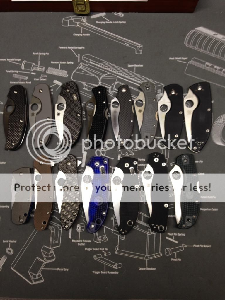

So I'm at the point of taking my sharpening to the next level. I have about 20 spyderco folders that value from $50-$250 so nothing really expensive yet. I currently have the sharpmaker and I'd like to make that work for another couple years. I've researched about sharpening and stropping until I'm blue in the face... Seems there's no right answer. So I'm faced with either buying a set of UF rods or making/buying a strop setup. Another concern is all of my blades are users, I don't need a blade so sharp to tree top hair strands but feel I can get better results. Having said that I've read that an extremely polished edge has trouble cutting skin and flesh (fish, fruit, vegetables). I'll # my questions for easier answering:
1.) Do I need a more refined edge than the fine rods can give me or do I just want more for no good reason? If the answer to this question is no, don't read any farther.
2.) Would I be better off buying the UF rods, a strop or both?
3.) If only a strop what compound would be a good progression after the fine rods?
4.) If using the UF rods along with a strop, what compound after the UF rods?
Thanks in advance for the help and I'll include a picture as I know how much you folks love em (5 more in route not pictured)!
